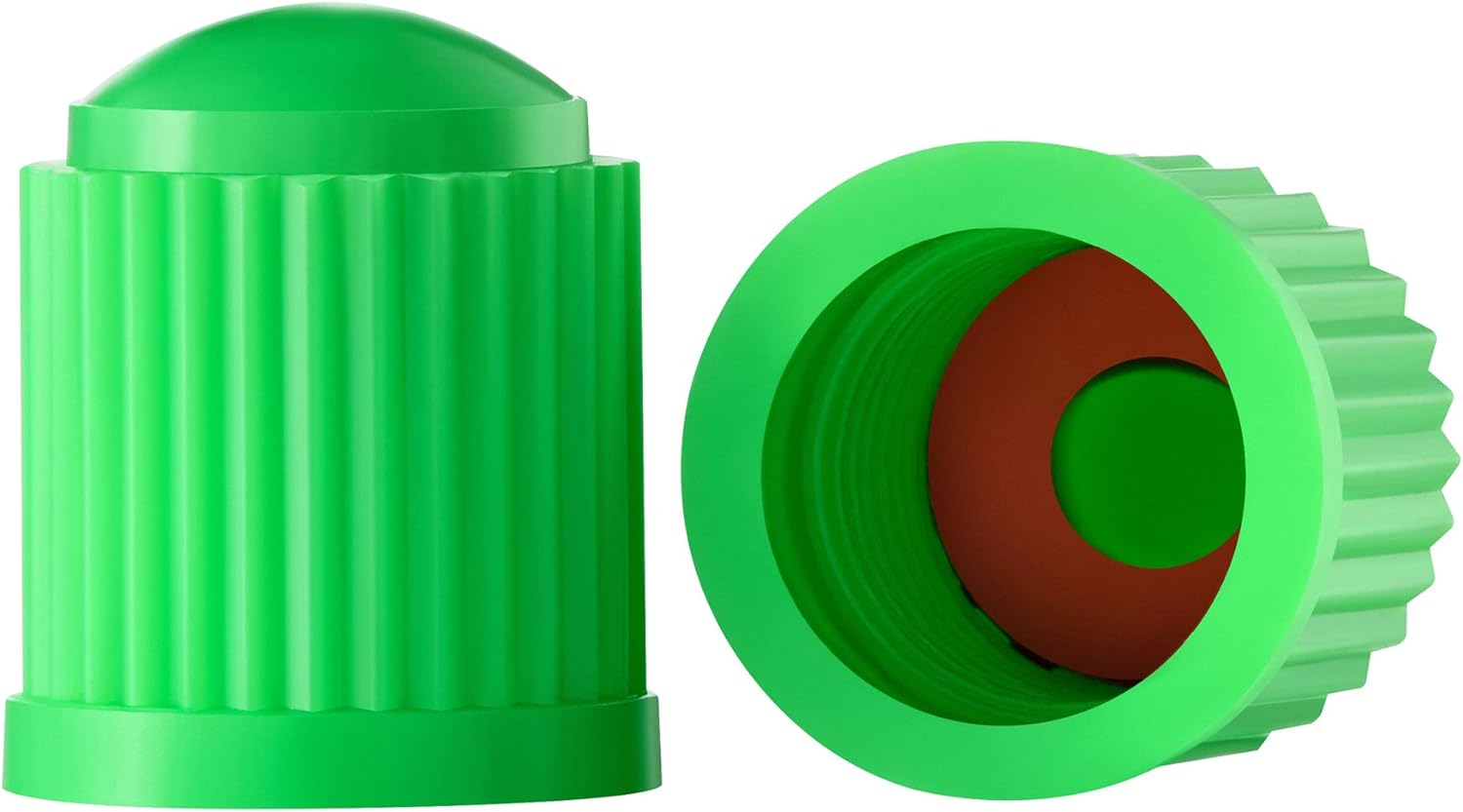

    The reason for that pressure drop is the condensation of water vapor in the tire. Perhaps you should consider filling with nitrogen and getting green valve-stem caps, indicating nitrogen filling. Ideal-gas law (if you had nitrogen instead of humid air), would give 255 K / 273 K × 36 psi = 34 psi. Tire pressure is measured when tire is cold.

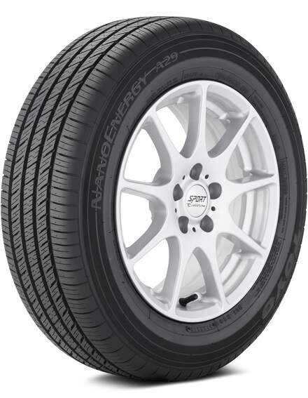

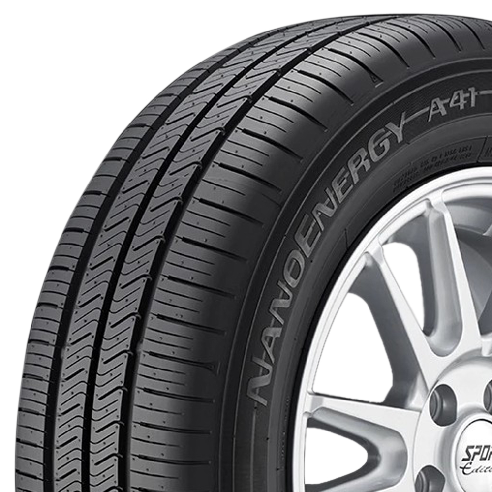

    ISO-metric tires have rounder profiles than P-metric tires, which would change the camber. Here are the Toyo NanoEnergy A41 (ISO-metric) vs. A29 (P-metric):
