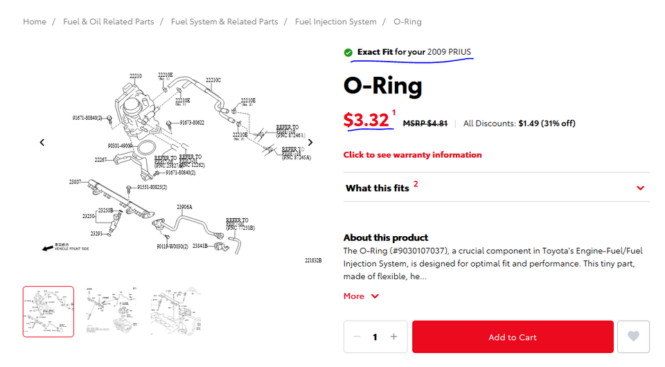

  8. JC91006
    JC91006 Senior Member
    Nov 10, 2013
    16,936
    8,647
    Fuel Injector O-Ring - Toyota (90301-07024)
    1997-2008 Toyota - 9030107024
    These are $5.31 each at my local dealer. I think when I bought them 6 months ago, they were even more than that. Absolutely crazy for a little piece of rubber

  10. saneesh8
    saneesh8 Member
    Jul 5, 2024
    238
    57
    Allen, TX
    Its lot cheaper here in North TX. Also part number is different for my car. The part number you provided, 9030107024, is $3.67 at this same dealer.
