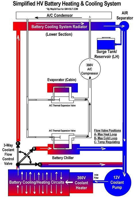

    GM think it is the electronics in the battery that is causing the fire. I looked up how it works and found the below article. There is high voltage (360v) heating element that may get activated when the control valve is stuck (due to the lack of coolant?). It is just a wild conjecture and the system is very complex so a lot of things are possible.

    That seems pretty unlikely to me. The power for that heating element should need to flow through at least one contactor (heavy duty relay) that would be disconnected automatically during a severe accident and the connections to the heating element should be quite isolated from the other high power cabling on the pack.
    I assume GM was speculating about the circuit boards that run along the top of the battery case above all of the individual cells. These boards monitor and control the battery and have connections to the cell groups used for monitoring their separate voltage levels during charging and use. The power bus bars that carry the full power across all of the cells are also located along the top of the pack. Something near the top of the pack might be indicated since reproduction of the problem seems to require that the battery is rotated upside down. I don't think any of us are in a position to judge what's going wrong.
