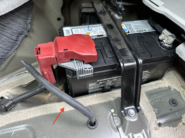

    When we were checking the 12v starter battery at the back of our 2011 Prius today, we noticed a loose tube (see photo).
    Any help on what this is? Should the loose end attach somewhere? Thanks in advance

    It is the vent tube from the 12V battery to allow any gases to be vented from the battery to the outside. This is to keep the gases from accumulating inside the vehicle. There should be a nipple on the battery where it attaches.

    The nipple is hiding under the positive terminal assembly.
    You should be able to push it on without having to disconnect the positive terminal.
    If you can't, make sure you disconnect the negative first, and write down your
    radio stations! :)

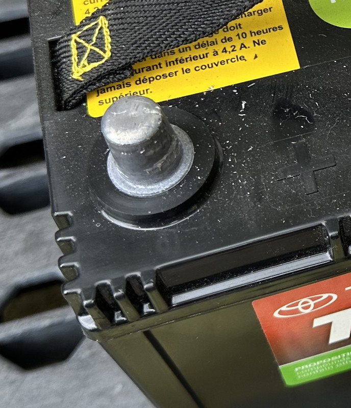

    Thanks. Here's a closeup of the positive terminal of the Toyota battery we just removed, which itself was a replacement for the original battery:
    https://i.postimg.cc/zfVrJJRd/battery-terminal.jpg
    Hiding in plain sight? Do all replacement batteries always have the vent duct?

    No, a lot of people put in non vented batteries and leave the tube hanging.
    It’s a safety issue . Some are concerned about it and some aren’t

    No. At least not exactly the same.
    And if it is an AGM battery, the vent should not come into play except in a
    catastrophic failure, like damage in an accident or a HUGE overcharge.
    I personally would not worry about it if the battery is AGM.

    Sorry, I didn't give enough information.
    Look on the SIDE, UNDER the positive battery cable.
    If it's not there, someone didn't tranfer it from the original battery.
    It looks as though that battery is a Toyota batter.
    You may have to go to Toyota and get the 90 degree angles plastic
    that plugs into the battery so you can attack the hose.
    I do see a plastic piece attached to the hose. So maybe it was broken off.
    And the rest is in the battery. At the Toyota dealership they should be able
    to show you a battery and where it goes....
