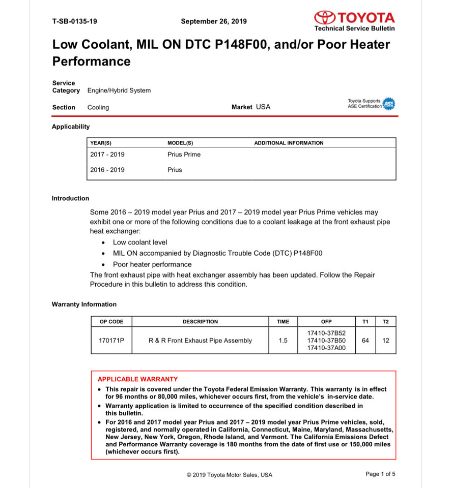

    Leaking coolant into the Exhaust Heat Recirc system at a high rate needs repair or bypass asap. Otherwise you risk a badly overheated engine and then a head gasket.

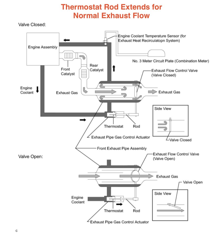

    After you verify Toyota won't repair it free (which could get you a new assembly), I would have any shop with a lift immediately do a below vehicle bypass.
    Option 1
    Bypass under the vehicle
    Option 2
    A no lift, no parts required driveway bypass requiring more time.
    Bypass in Engine Compartment requires Wiper Assembly and Cowl Removal
    Long term a bypassed heat recirc/exchanger should have the internal actuator forced open. However this is not an immediate requirement as an exhaust flow still exists and normally exhaust pressure alone will open the straight through path.
