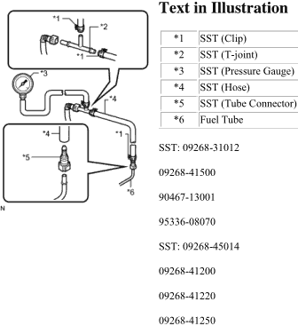

    You learn the most by putting a pressure gauge on the fuel line and checking that the pressure in operation is within spec. It's a bit involved because there's no supplied place to attach a gauge. Even at a dealership they'll just unhook the hose at the firewall and MacGyver something up with a tee and fittings. They have part numbers if you want to do the same 'official' MacGyverage that they would.

    My Sap on gauge comes with these fittings to cobble this setup. So tech doesn't output fuel pressure maybe it just knows if the pump is supposed to be on or not. Which is typical in my power sports equipment My EFI bike will start but as soon as I try to give it a little bit of gas when the fuel pump is acting up it will fall on its face because it doesn't have enough pressure to get into the progression phase or whatever is going on I changed the pump all is finished working perfectly this has happened in a couple of my Corollas over the years very similar. These pumps that I'm pulling out of these vehicles are well over 100,000 miles except for the power sports equipment which are at about 50 or 60 which is a lot for power sports equipment like motorcycles and snowmobiles etc
