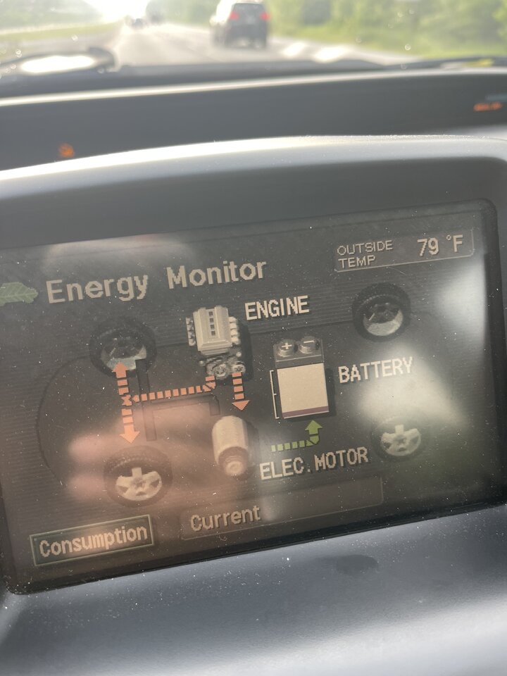

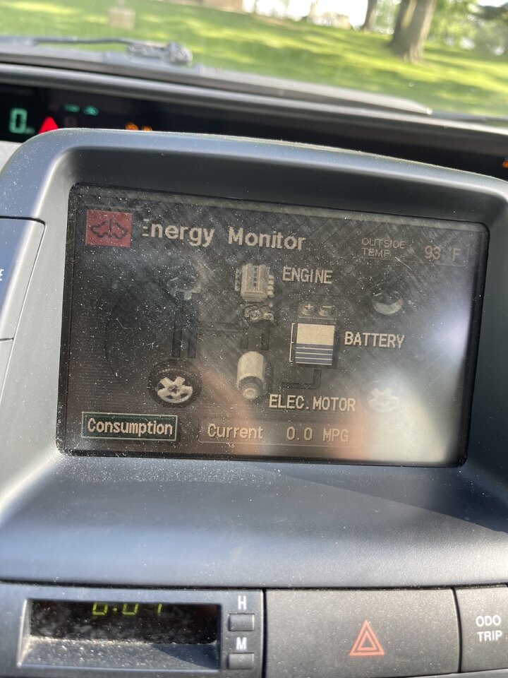

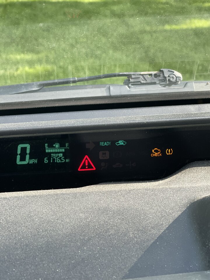

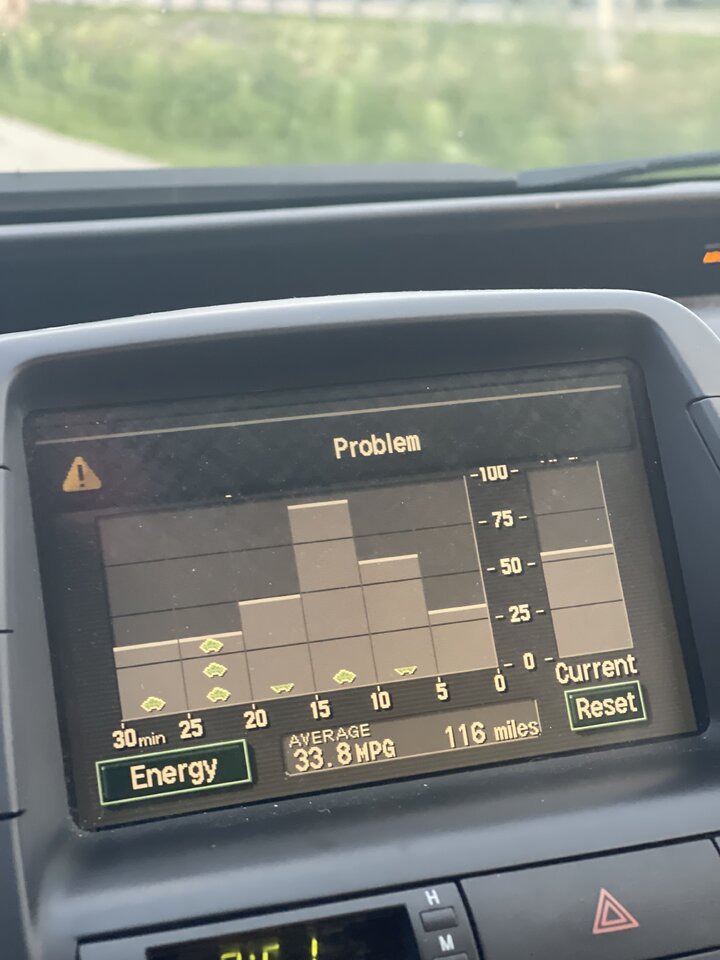

    Hello all, I am new to the Prius world. I inherited my dads Prius when he had to go into the nursing home and recently passed. The car has about 250k miles on it and is doing rather well until today. I have put a new normal battery in it and a new hybrid battery in it back in November. Today when driving the battery indicator on the display screen was down to one bar. Normally it's full. I was able to get it up to just about halfway but it wasn't green. Driving home from work the red triangle of death came on and won't turn off. I shut the air off in hopes that would help. It's helped in the past. But so far no go. It makes a beeping sound when I go around a curve and before the red triangle would flash. Now it's saying problem and it's turning a light that looks like an oil can on. I just had an oil change done in March. And I know it's not the light that comes on for an oil change. It's also ticking when running. I haven't had the check engine light read yet. That will be a tomorrow thing. The tire light is always on and even though we have aired all the tires up it stays on. What concerns me is the battery indicator level (it's blue right now) and the red triangle of death. Another light that popped on for a hot minute was the circle inside the parentheses with the exclamation point in it. It wasn't on very long. The oomph that the car usually has doesn't seem to be there any more and the air wasn't as powerful as it usually is. To me that sounds like an alternator. But I am not sure. Whatever it is I hope its a cheap fix.

    Having an oil change done in March is pretty much irrelevant at this point. Did you check the oil level when you received the car back?
    That 'oil can' light (which I don't see in any of your photos) comes on when there is no oil pressure. No oil pressure means no oil. You need to stop running the engine immediately and do not run the engine or drive the car until you have checked the oil level on the dipstick. If there is no oil registering on the dipstick, add oil to the engine, initially 1 qt at a time, then check after adding each qt. Once you get oil registering on the dipstick, add ½ qt at a time, continue checking the level after adding each ½ qt. When the level is between ½ and ¾ the way up the dipstick, stop adding oil. Do not fill past the top F mark.
    Usually, when that 'oil can' light comes on, damage has already happened in the engine.

    ^ This. As long as you have the oil pressure light appearing, or the red triangle flashing when turning corners, there is no other problem the car has that's important enough to spend time on. Deal with the oil problem, promptly, or no other problems will matter.
    "No oil pressure means no oil" a lot of the time, but there can be other causes of no oil pressure. If the dipstick shows oil but the light still says no oil pressure, you still have an engine-destroying problem, that still needs to be found and fixed.
    The only time the oil-pressure light does not mean an engine-destroying problem is if the light is coming on falsely because of an electrical fault in the oil-pressure warning circuit. That's like the coin-landed-on-edge scenario and it isn't hard to check for. Unless you check and find that, the oil pressure light is dead serious.

    My bad, didn't read the entire first post to the point where the OP mentioned the oil warning light. The light wasn't in any of the pictures posted. That is probably a good thing (not being in any of the pictures), because if there was a hole in the pan, the oil filter fell off, or any other "lose all the oil once and for all" conditions that light should be lit all the time. Ticking is not a good sign though.

    I had a hybrid battery company install it. We had the code read yesterday and it was just the evap code that came up. We did add oil to it and it turned all the lights off except the check engine light. However it still ticks when giving gas and the battery isn't fully charged. It's not low to one bar but it's not full. It could go another 3 or 4 bars to full. I just wonder if the "alternator" isn't working well.
    I had the codes read. The only code it gave me was the evap code. I can reach out to the guy that did the install. Maybe he will be able to help with the battery issue. My son added oil to it and the red triangle of death light went away. So that helped. It still ticks when we give it gas but it's better.
    We did just that. I put two quarts of oil in it. That helped a ton. We read the codes and the only code that came up was the evap code. It still ticks when you give it gas. And the battery indicator on the screen is still not a full charge. It could go another 3 or 4 bars to be full. So I don't know what else could be wrong. I will send the pictures to the guy that installed the hybrid battery.
    The oil can light would only come on every once in a while. We did add oil to it and that helped a lot. I will have my son check the oil level today and see if we need to get more. We put two quarts in.
    The only code that comes up is the evap code. It was a new battery installed by a hybrid battery company. I paid a pretty penny for it that is for sure. We did end up having to add oil to the car. That helped. It still ticks when we give it gas. I am going to reach out to the battery guy and have my son check the oil again today.
    We did take care of that problem. It helped a ton.
    I wasn't able to get a pic of the oil can light. It came on and then would go right off. I did have my son add oil to it. We added two quarts. I am going to have him check the level again today. Adding oil did help. I don't know if the oil pump is failing. My dad bought it used almost two years ago. He passed away so I can't really ask any questions.
