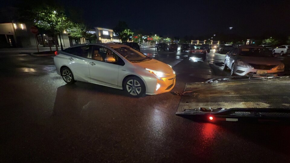

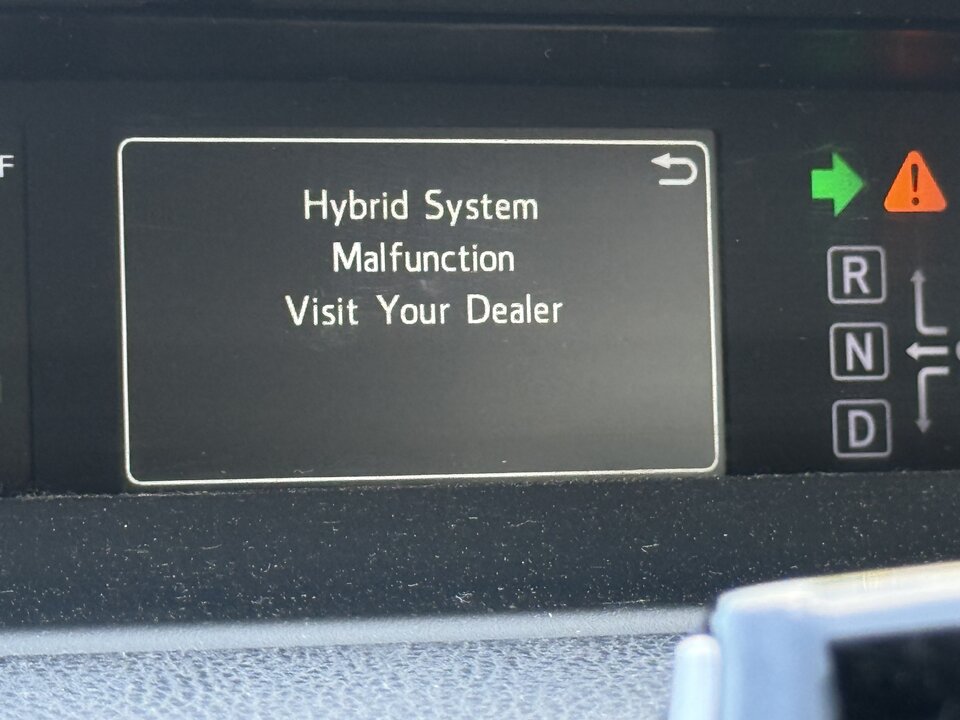

    I also had exhaust the last two mornings but only for a short time. Well on my way home from work I kept hearing the clanking noise or whatever coming from under the hood and my car literally died. Wouldn’t drive anymore. I got a message about a hybrid system malfunction. Had to get it towed to a shop I’m praying it’s nothing too serious.

    2016 model year is first year of gen 4, prone to coolant leaks in the exhaust heat recovery system, engine can run out of coolant. Just one possibility.
