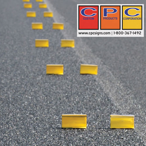

    NO, that is not what is being talked about. Some folks call them road turtles, when googling the term I found that "Botts Dots" will bring up the image of the item on the highway. They are used to mark pavement and also crosswalks and stop bars along with other items.
    Botts' dots - Wikipedia, the free encyclopedia
    On some roads, lanes are marked only with a mix of Botts' dots and conventional reflective markers, eliminating the need to repaint lane divider lines. Botts' dots are rarely used in regions with substantial snowfall, because snow plows damage or dislodge them.
    Many states in snow-prone areas of the Midwest and Northeastern United States use Stimsonite reflectors placed into protective metal castings, which allow them to be plowed over without being dislodged from the road surface. These pavement markers are usually augmented with reflective paint and delineators placed on plastic or metal posts at regular intervals along the edges of the road. In California and other locations in the Southwest United States that experience occasional but significant snowfall, the Stimsonite reflectors are placed into recessed pockets in the roadway, which allows visibility during dry weather but permits a plow blade to travel across the reflector without dislodging it, with no special protective castings needed.

    Regarding the road reflectors, dorunron's description is accurate. Around here, they are rectangular (Stimsonite design), not round, but same idea. They don't use those thin vertical flappy ones.
