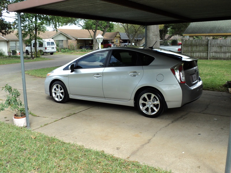

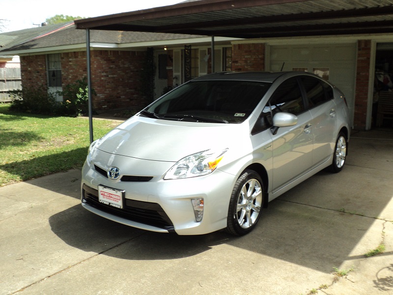

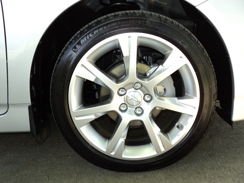

    Lot of difference between each model. I opted for the Model III to get the back up camera. Didn't care about the nav since I already have a Garmin Nuvi but am using the onboard nav unit along with the Nuvi on certain occasions. I like the fact that everything is built in. Less trouble when it comes to park and secure the car. If the thieves want it, nothing will stop them. At least built in will slow them down some. Not much of a price difference really between the models. At least you have a Prius. We started with a used 09 Gen II Package 2 unit. Drove it three years, then traded it in on the new 2013 that I got 3/31/14. Last years model purchased at the end of the month and the end of the quarter. Got a great deal, but did a LOT of negotiation.
    Enjoy your new Prius Glen.
