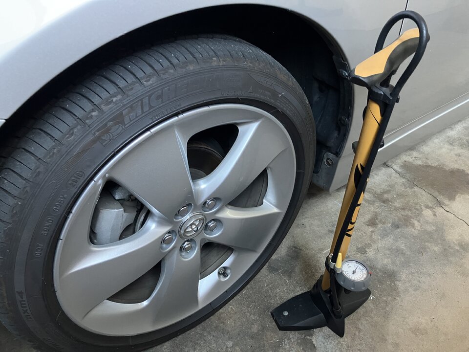

  8. Mendel Leisk
    61,601
    42,376
    How about this mode:
    bob12345, Gokhan, bisco and 1 other person like this.

    Give it up, Mendel. If you had a digital tire inflator, you would never go back to that one. I used foot pumps for many years before I got mine last year. LOL
    The instructions clearly state to run the car while you use the inflator. You are not supposed to use it in the accessory mode. Fortunately, Gen 5 also has a my-room mode when plugged in.
    Mendel Leisk and bob12345 like this.
