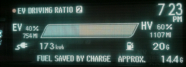

    Can you take a screenshot of the EV DRIVING RATIO screen? That has a lot of information and we can work off from there. There are two screens (1 and 2) that you can flip with the TRIP button. The one that you have not reset (lifetime) is better. Below is mine, after about 2 months of driving.
    I have no problem accelerating 50+mph in EV mode and keep up with the traffic here. I find ECO mode easier to control and maintain in EV mode. The accelerator mapping becomes less sensitive and it helps to not trigger the ICE.
