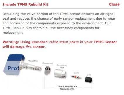

    Greetings all. While shopping for new tires for my 2006 today (185/65-15) my quote from Les Schwab lists a $7 per tire "Tire Pressure Monitoring System Rebuild Kit." Any idea what that might be? I assume there's a battery in the tire monitors. How long are those supposed to last? Having those working has saved me some heartache a couple of times now, so I would like to keep them healthy. Not so happy about doing things just because somebody lists it on the invoice.

    5-10 years.
    Besides places that are trying to stick you will try and sell you new sensors with the battery built in for $60 a piece instead of rebuilding them. $7 sounds like a deal if it's a 2006 with the oem TPMS.

    Does a standard TMPS rebuild kit include a fresh sending battery or just a new 0-ring seal? I didn't think they replaced the batteries every tire change but maybe I am mistaken there.

    I don't believe the battery is replaceable. And they're for sure not doing that for $8. I believe they replace some O-ring. I'd be inclined to waive the service, just tell them to leave the TPMS alone. Knowing most tire shops, they'll try to draw you into a debate, or even lecture you on your suicidal tendencies, lol.
    A few responders here said they've been through two or three sets of replacement tires, never touched the TPMS, everything fine:
    Are the valves and TPMS one unit? | PriusChat
    In Canada TPMS is not mandatory, yet. I'm thinking to run them 'till they quit, then just get conventional valves the next time.

    Not a new battery..

    If they aren't swapping the battery i'd skip it. You can replace the battery but it requires surgery on the TPMS brick and if they aren't doing that you might as well wait and get a new unit when the first dies.
