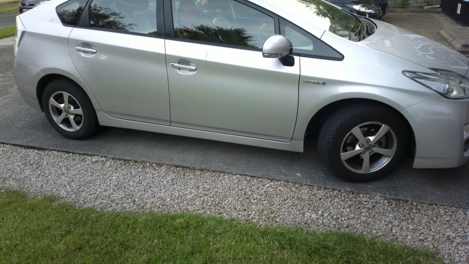

    i am in ireland too...i just bought 4 alloy wheels on done deal for my prius size 15....with 195/65/15 tyres on .....immediate improvement in mpg....and i have'nt put new tyres on yet
    bolt pattern is 5x100 so it pretty standard......
    i have set for sale if your interested

    there is a thread here somewhere...with a mindbobbling amount of different wheels on....the important thing is the bolt patteren 5x100 and the offset of 45.....although offset 35 works fine.
    see mine in picture
    all versions prius wheels will fit all prius.....plus many other toyota wheels from auris....avensis etc
    check this out Gen III aftermarket wheel thread...post your pictures | PriusChat
    if your interested in fitting 15 tyre there are many benefits.....but you will need 15 wheels and your not limited simply to prius only wheels
