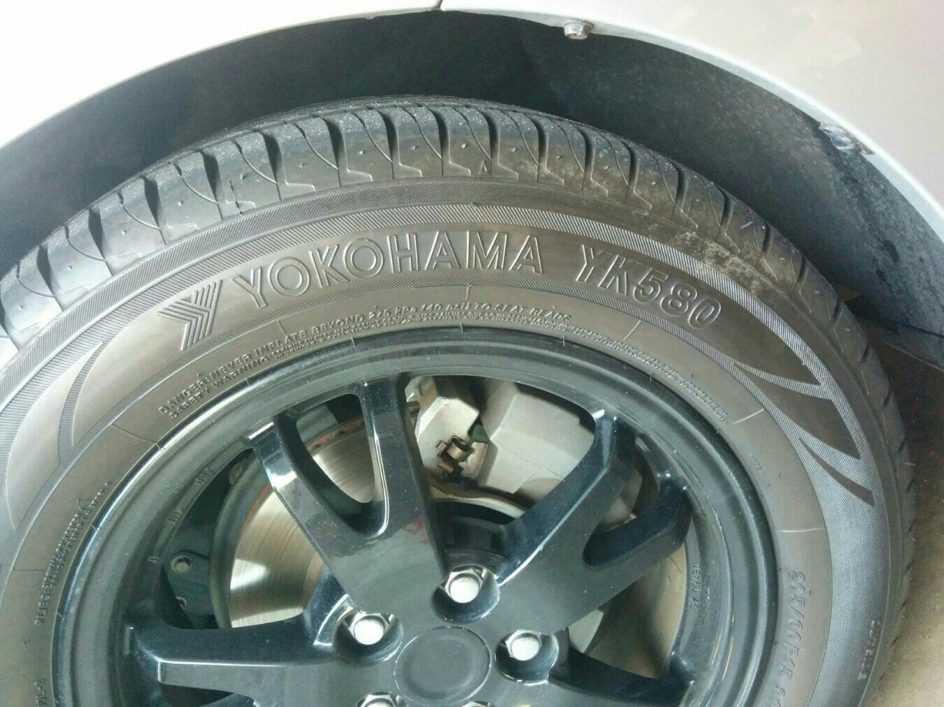

    Been getting averaging about 51 - 52 mpg on these. Had them for about 10,000 miles now. Size is 205/60R15.

    YK580's....I have had mine for 18,000+ miles, in 195/65 x 15. Great tires!
