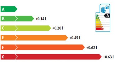

    Previously I had Ecopia EP001s A/A rated tire, now I have Pirelli P1 C (rolling) rated tire, the diference is noticeable but it's hard to put in numbers, I would say at least 0.3 l/100 km diference.

    Sure does but 225 is much cheaper and still you can find it in A class. Thanks for the note though. Thanks also for the information about the numbers. 0,3l sounds quite big to me. It's 180 litres of fuel if the tires last for 60k killometres and it means 252€ with current petrol prices.

    What comes to this, it seems you may even be right! I found this picture:
