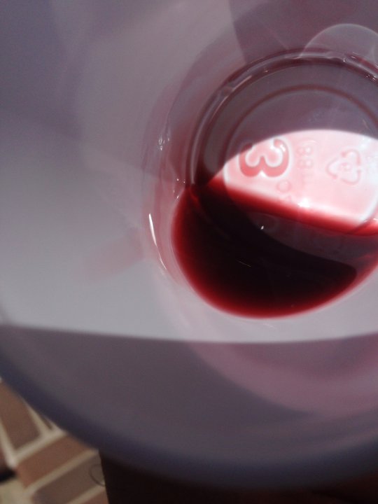

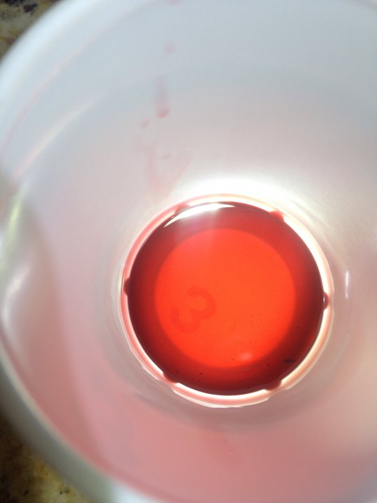

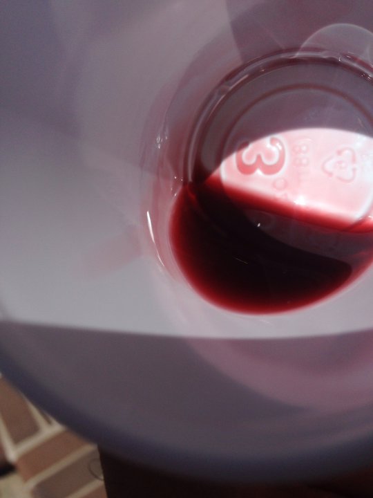

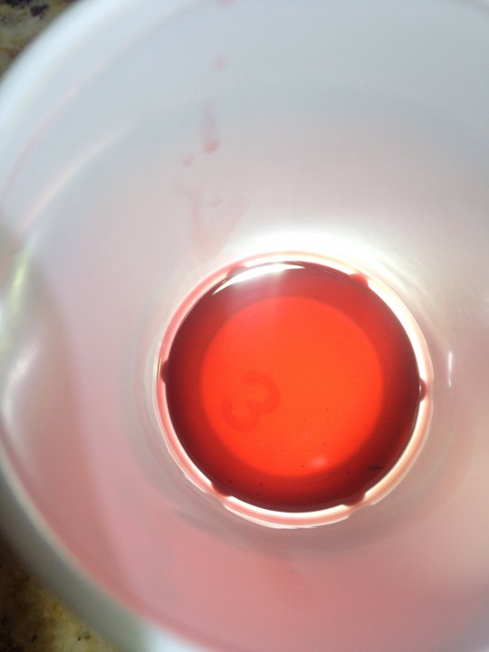

    4724EECC-E01C-47A5-9984-9627477D120E.JPG 5561F3A0-B76F-4685-9144-D16529A6455A.JPG
    first pic is sunlight. second is a high power flashlight.
    I pulled a little fluid. It almost smells gasoline ish. A mix between that and oil. It seems pretty dark. There was a dark haze as if there's a cloud of shrapnel. I took a pics. I also spread some fluid out on a white piece of paper to clearly see the debre. There are slivers of what looks like copper all throughout. I need to look up where to send the fluid to see what's said. I feel I should take it to toyota to check it but last time I paid them 300 dollars to do it and they checked the battery instead... And the brakes, etc (even though I told them not to)

    that fluid looks pretty good

    seemed dark to me. the only way to see through it is with my spotlight.
    that sample is from me lostening the plug, not fully temoving it.
