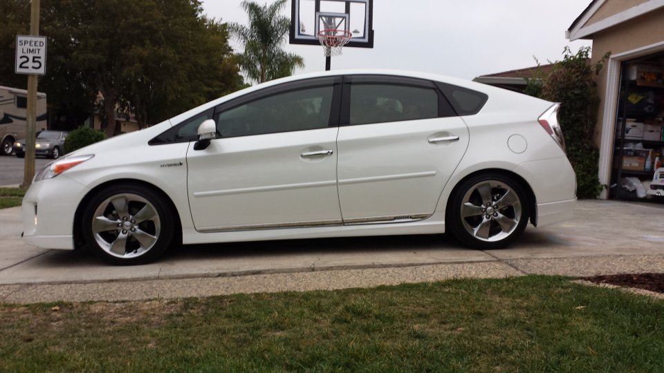

    I have the TRD Springs on my 2013. I like it alot. The drop is mild enough to reduce that annoying gap but enough clearance, even with the plus kit that it does not scrape. I went with the TRD because toyota specifically made it to work with their shock/struts. 20141010_074128.jpg

    Good to see it worked out for you as well!
