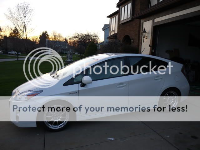

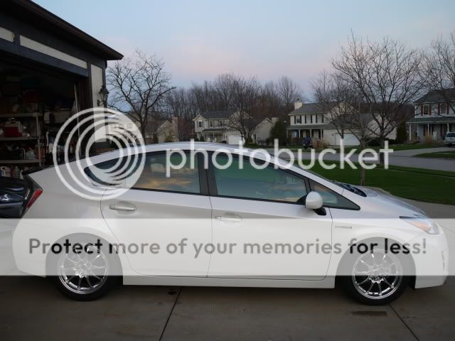

    Alright guys got my wheels on, but it got toooo late for a photo-shoot lol I'm kinda unhappy with the look right now but I'm gonna post the pics anyways because I know it might help someone looking for a aggressive wheel offset.
    My setup is Tanabe DF210 springs, Volk racing 17x8 +44 with Ichiba 10mm spacers in the rear, Kumho ECSTA MX 235/45/17 all around which looks too chunky, I had these tires laying around the house so it was inexpensive. I think 225/45/17 with coil-overs would be my next purchase. No rubbing at all right now, but once I get my coilovers I'm rolling the fenders.
    As for MPG, I got around 52 mpg with the stock 15 inch... Now I get 49 mpg on a 17x8 wheel which surprise me. I guess weight is the key, the wheels are around 14lbs but the tires is where the problem is... if you guys have any questions or advice let me know, once the car looks better I'll take more pics. Thanks brandon
