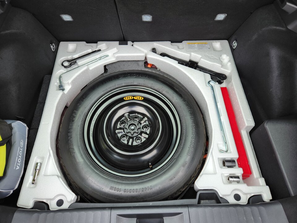

    If looks isn't a concern, just pull the foam out and put something down the protect the floor and cable for AWD in those models. The parts from the LE can also be swapped in. Such has been down for the spare tire.
    That works for the hybrid. It is different for the PHEV. The car's charger is under there and to the side. A totally flat floor like in the hybrid isn't possible. Neither is adding a factory spare assembly.
