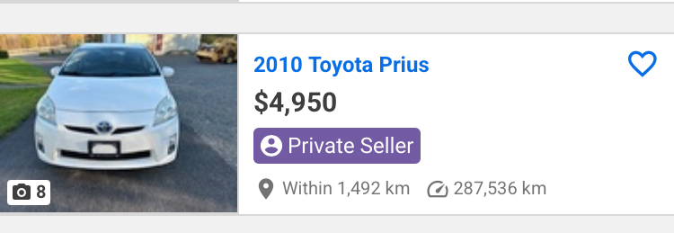

    I'm not saying right now while there's still Gen2 Prius everywhere... My examples were referencing vehicles from 40 or more years ago... As in I'm talking about a long term investment that you need 20-30 years to mature. As for Bring a Trailer, that's an auction sight for hobby collectors, not professional curators who work for collectors with deep pockets. And again, the amount of documentation you gather up today, will massively boost the value of the vehicle in a couple-few decades.
