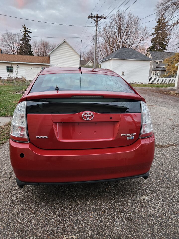

    Meanwhile I'd noticed the exterior lichen had caught the attention of folks who walk down my alley. It was hard for them to not pick at the car as they walked by. So I left a nice sign that said Biohazard Do Not Touch on the car. I figured that might deter the casual passerby.
