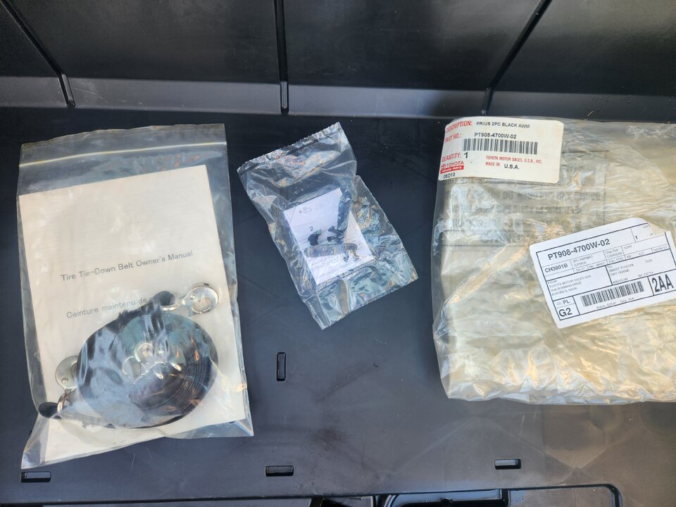

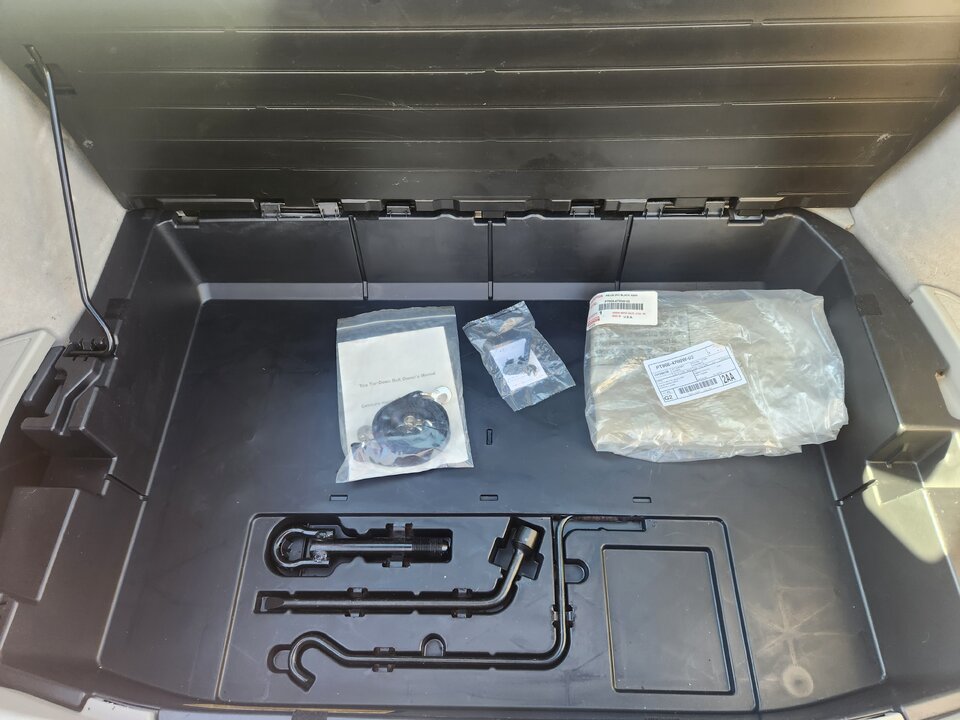

    Took care of some small items
    Cleaned up and gathered items for the the rear under storage tray. Jack handle, lug nut wrench, prop up bar.
    Found tie down straps and instructions. Was going to throw out the bag for the floor mats, but found floor mat hooks in there. Glad I checked. Set the hooks separately and folded up the bad and kept it.
    On the dash I was going to "fix" the tab that was not affixed on the CD warning label sticker. Realized that that's actually how it came and the unaffixed section was so the owner could more easily pull off that sticker. Decided to leave it in place.
    Re-affixed the airbag warning tag on the glove box edge. Cool to have for completeness.

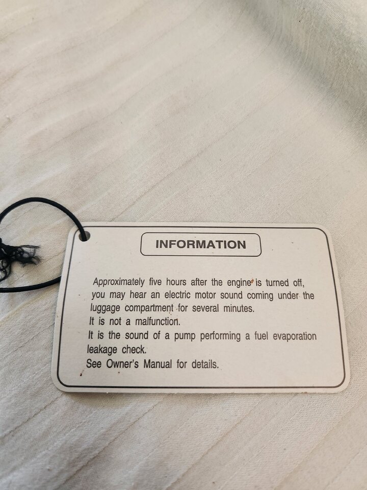

    Here are some other warning tags that came with the car. Basically explaining odd noises the car may randomly make.

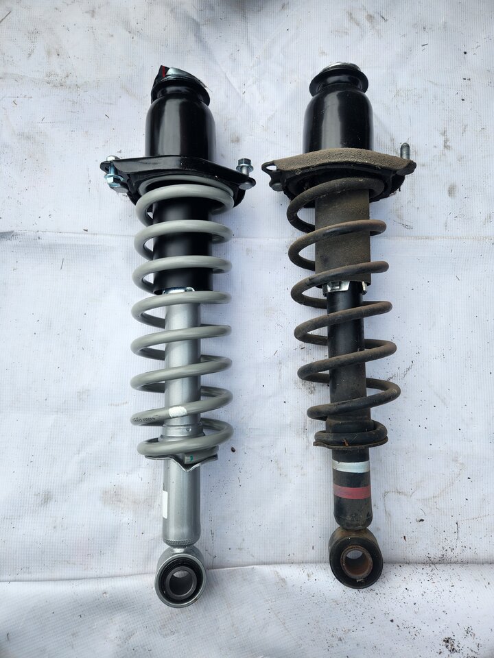

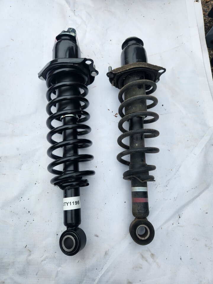

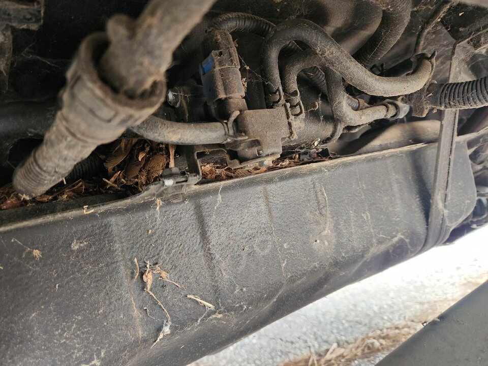

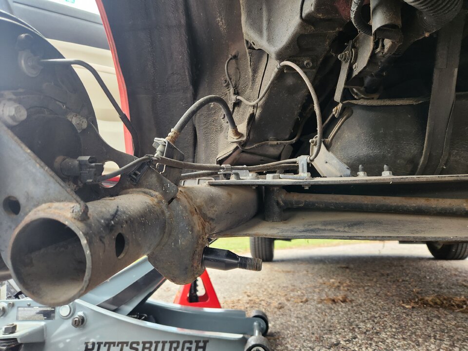

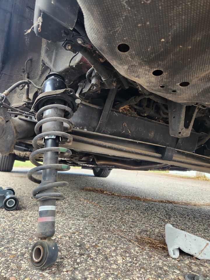

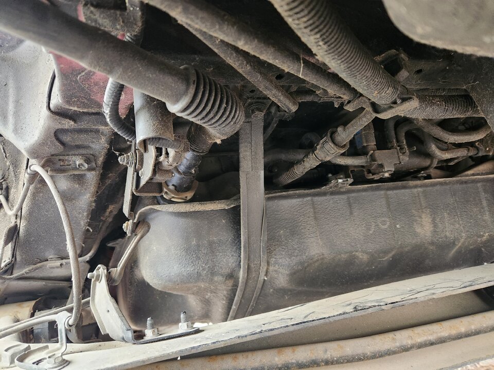

    When I took it to the dealership for the oil change they gave a multi-point inspection.
    They identified that the rear strut assemblies needed to be replaced. Slight leaking.
    So I grabbed a set and installed them today.
    Overall there were quite a few cobwebs and leaves in the wheel wells and the underside of the car. Quite a bit of debris tucked up on top of the gas tank lip. So I vacuumed/blew that out while I was underneath there.

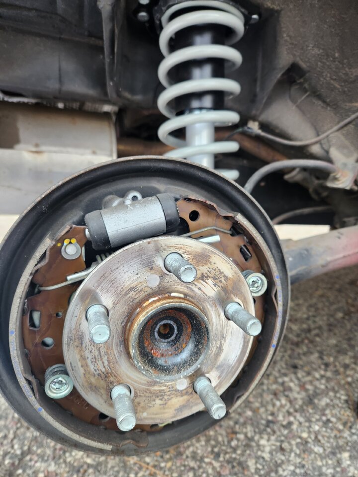

    Also pereed at the drum brakes, which of course look great.

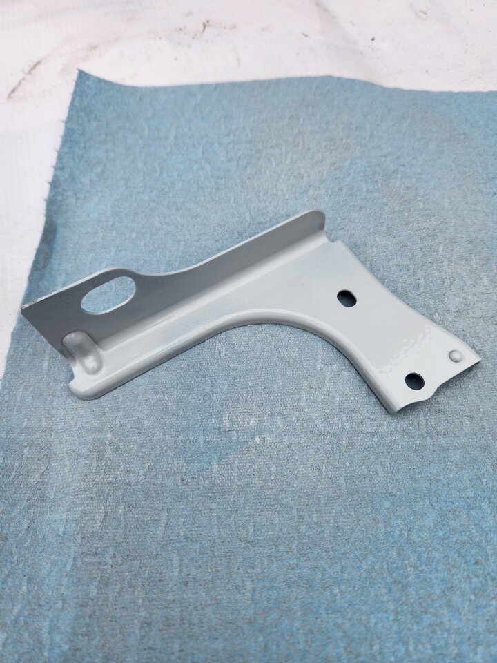

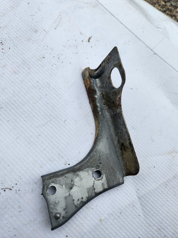

    Also refurbished the bracket for the brake booster capacitor. It was little crusty.

    Last time I opened mine there was quite a bit of brake dust. They didn't look like your picture until after all of that was removed.
    ericbecky likes this.
  11. ericbecky
    ericbecky Hybrid Battery Hero
    Mar 12, 2004
    4,440
    3,308
    Madison, Wisconsin
    First time they've been opened in over a decade.
    I bought the car without even turning it on. I wasn't even sure if it would move. There was definitely a possibility that the brakes could be locked up just from sitting so long.
    I was pleasantly surprised when I could put it in neutral and roll it.

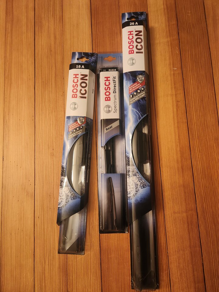

    Put on some new Bosch Icon Wiper blades. I've had them before and seem to last a long time.

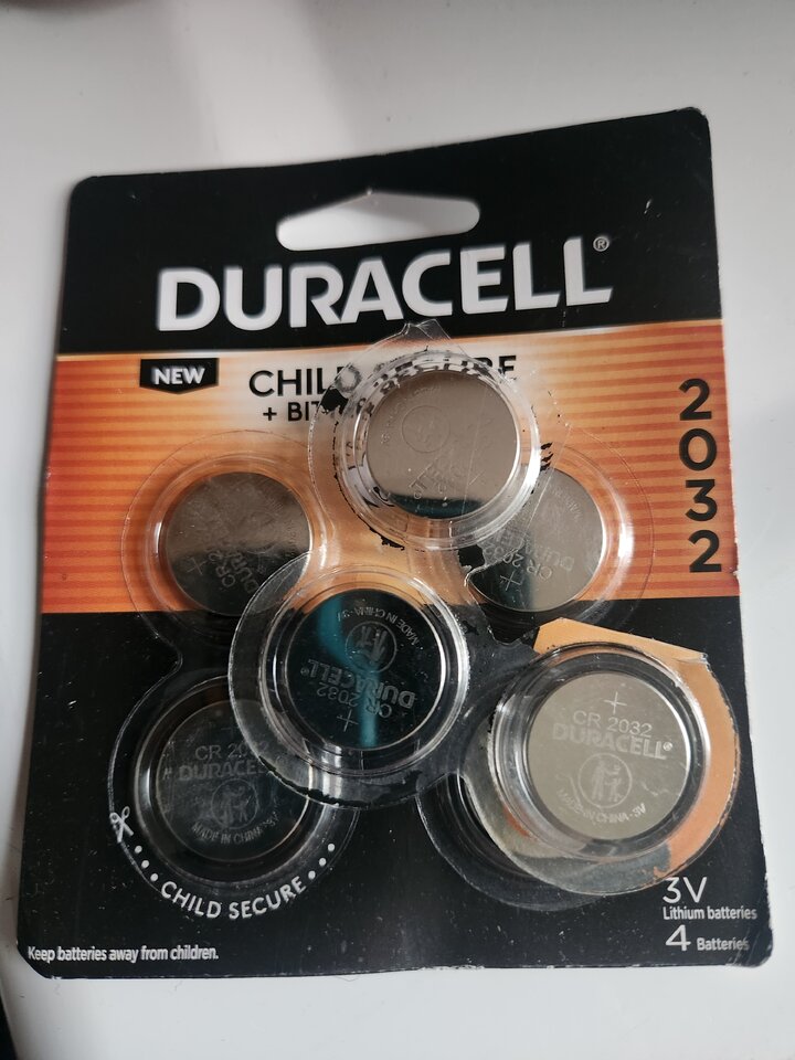

    Replaced the battery in the spare fob with a Duracell 2032. Double checked that it was fully functional. Yep! Good to go.

    IMO to keep the original appeal, I would have installed original Toyota wiper inserts if the car still had the factory metal blades. The Toyota inserts are replaceable and work very well, especially the rear factory blade.
    Front Left Windshield Wiper Blade - Full Assembly
    Part Number: 85222-47020
    Right Front Windshield Wiper Blade - Full Assembly
    Part Number: 85212-47021
    Left Front Windshield Wiper Insert - Rubber Insert
    Part Number: 85214-44140
    Right Front Windshield Wiper Insert - Rubber Insert
    Part Number: 85214-46011
    Rear Window Windshield Wiper Insert - Rubber Insert
    Part Number: 85214-47010
  14. ericbecky
    Mar 12, 2004
    4,440
    3,308
    Madison, Wisconsin
    Good thought. I'll keep the originals in storage just like I kept all the original other parts.

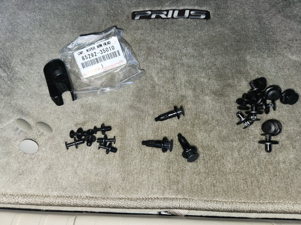

    I got a few small plastic parts from the dealership today.
    During disassembly some of the plastic fasteners were too brittle and broke.
    In other cases, they previously had been replaced with the incorrect fasteners, like on the engine compartment front trim piece.
    Headliner, engine garnish, bumper, in ER wheel well shields.
    I also got a new cover for the rear windshield wiper arm.
    None of these things are critical, but feels better to replace them properly given how complete the rest of the car is.

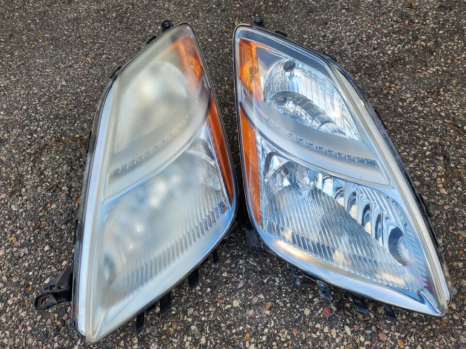

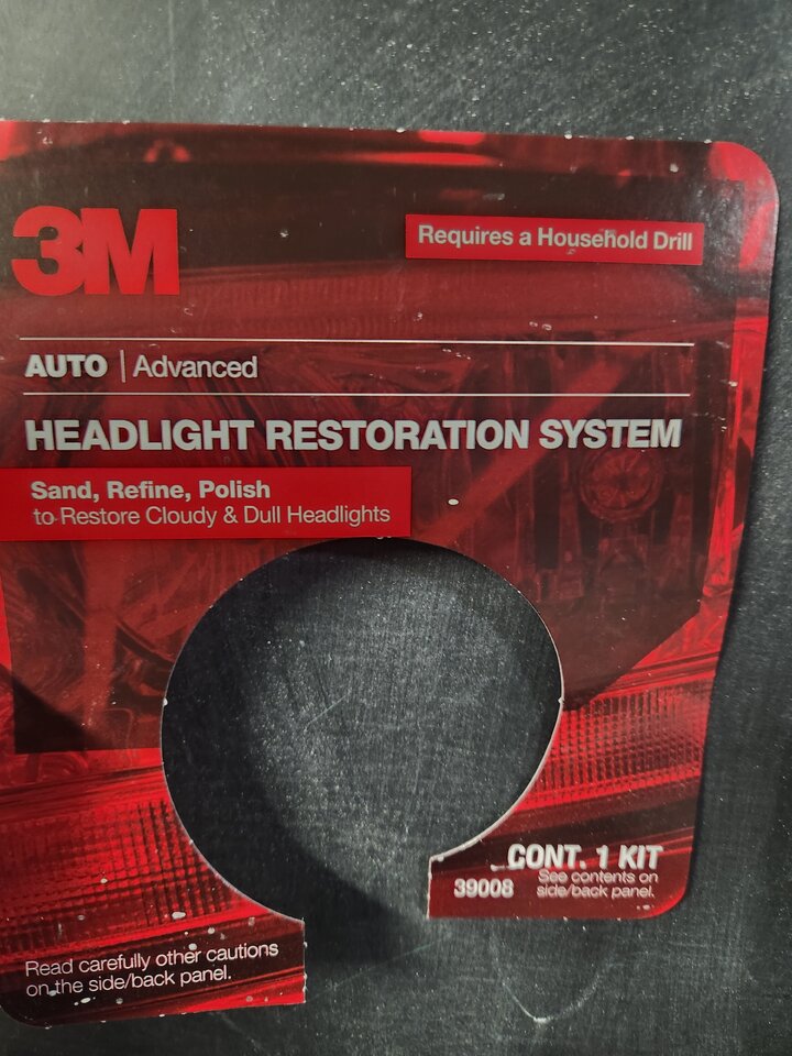

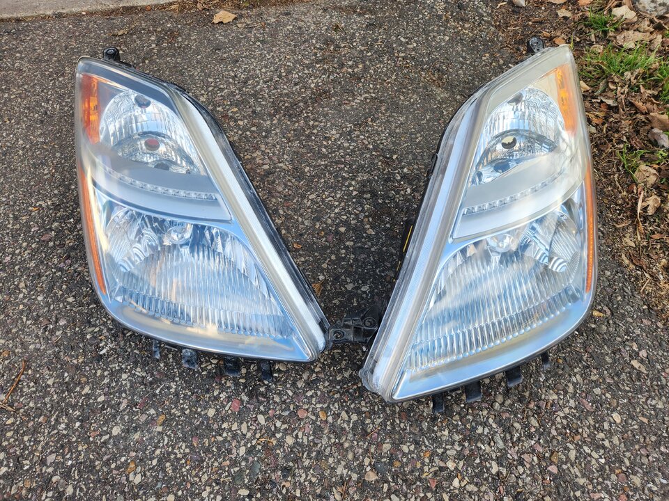

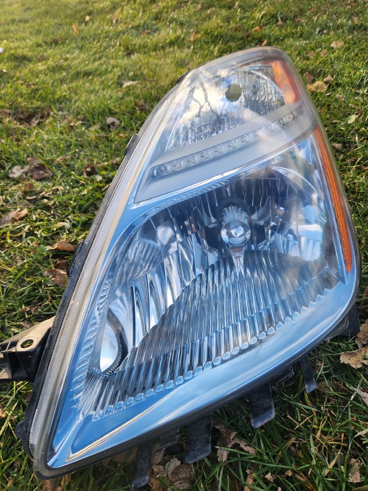

    Polishing up the headlights today.
    Here's an unpolished one and the polished up one for comparison.
  17. Mendel Leisk
    60,264
    41,463
    Looks much better. How long did that take you, and what did you use?
    ericbecky and Prodigyplace like this.
  18. ericbecky
    Mar 12, 2004
    4,440
    3,308
    Madison, Wisconsin
    Takes me 30 to 45 minutes per side.
    I find it easier to have the headlights out of the car to do it. It's so messy.
    I use the 3M headlight restoration system. #39008 (FYI. This forum automatic makes its own link for this product, although it's probably wrong. I didn't create that link.)
    You need that drill for attaching the spindle that holds the sanding and polishing pads.
    It has really good instructions.

    I suggest before going whole hog on a headlight first try washing it thoroughly with some Dawn, then lightly polishing it (I have some ancient Turtle Wax metal polish, probably almost any polish will work), then coat with Nu Finish (the liquid car polish, not their other products). Often the haze results from dirt trapped in fine pits and scratches, and removing that, then filling the defects with Nu Finish is good enough. It doesn't remove (much of) the original lens coating, or if that is gone, the plastic underneath. That is all I have done on our 2007, which we bought used in 2019, and its headlights looked that bad by about 2020. Going this route it is necessary to wash off the Nu Finish every 4-6 months and reapply. I have tried other coatings in the past and they either got dirty faster (wax) or actively attracted dirt (a silicone based product by Blue Magic).
    If after cleaning a headlight (first step above) it looks clear when it has a good coat of water on it then this should work. If it still looks cloudy with water on it then the plastic itself is damaged internally and it must be sanded down enough to remove that damage.

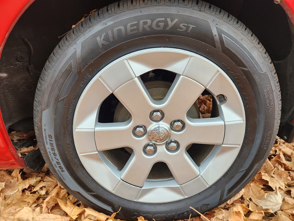

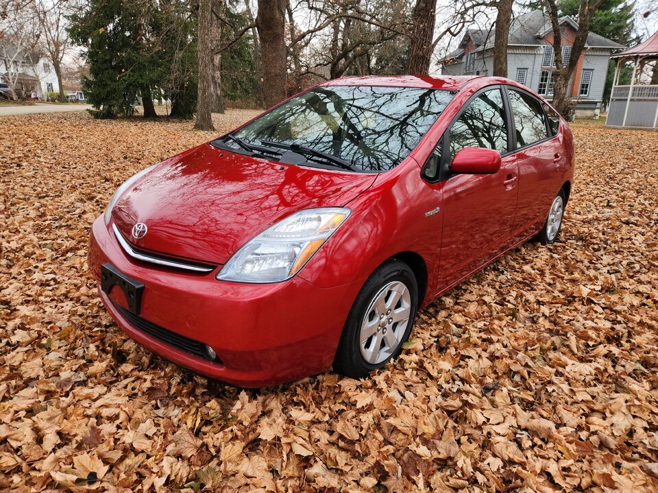

    Put the trim rings back on the rims.
    Went out and took a bunch of pictures.

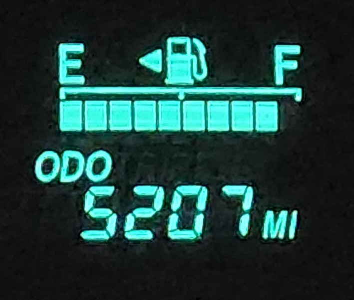

    The odometer turned over to the next mile, even though I only went 3 blocks. Now at 5,207.
    Looks like may be back to putting it up for sale. Relative may not want it.
