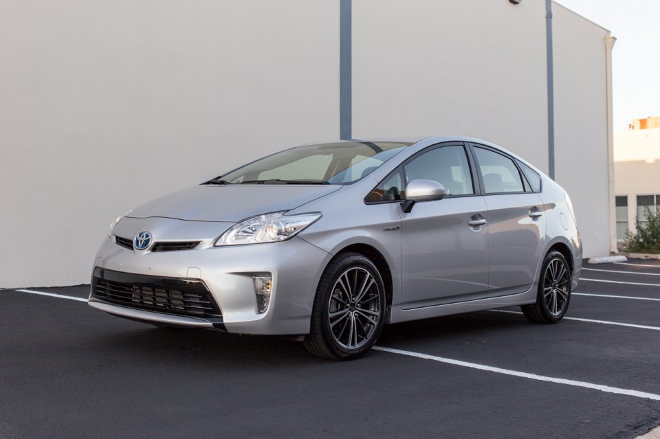

  11. bwilson4web
    29,108
    16,544
    Was that bumper inlet standard or extra?
    I like it because it reduces the area and brings the edges in a bit. Not quite efficient as a total block, anything that reduces the air 'ducking in and spilling out' of the lower inlet is going to reduce high-speed drag. I found about a 2 MPG improvement at highway speeds using a total air block because it stopped the excessive cooling flow.
  12. E46Prius
    E46Prius Active Member
    Aug 3, 2015
    314
    220
    Costa Mesa
    Hi Bob. Are you referring to the black part of my bumper? It's standard. Is there another one I'm not aware of? Mine is a 2015. Looking at the pic though did make me want to mod my grill. Looks like a big area to create drag behind.. but I live in a hot climate so maybe I should not experiment with my new car haha
    bwilson4web likes this.
