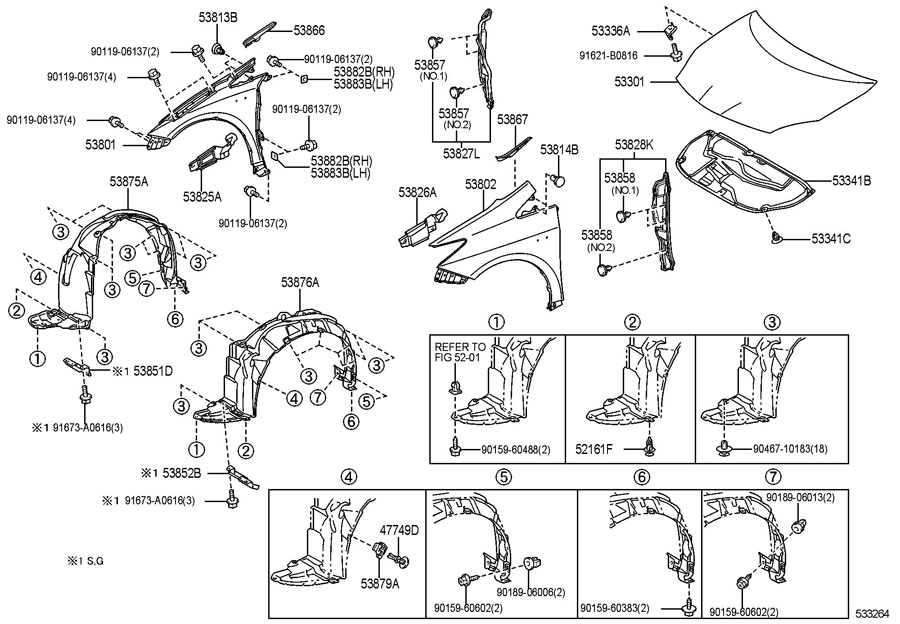

    I'm looking to replace my front driver fender liner.
    Are there universal retainers or clips I may use for this DIY project?
    Another post noted that 11 of the 90467-07164 is required for each fender liner in front.
    Fender Splash Shield Push-Type Retainer
    Black Nylon
    Head Diameter: 20mm
    Stem Length: 10mm
    Fits Into 7mm Hole
    Will this fastener work similarly for a 2011 Toyota Prius front fender liner LT?
    The attached diagram indicates there are 10 different fasteners/screws/clips/what-have-you's to replace the fender liner. It's a tad bit pricey to get each one... as you can imagine.
    Any advice would be appreciated. Thanks!

    I called the dealership and he quoted me $27 total per the diagram above.
    Body shop lists two that's only required: 9015960488 and 9046710183. However, the first one is a metal screw, which doesn't make sense. There must be a similar plastic fastener that fits the bill.
    90159-60488 (21838):
    M6.3-2.5 x 24 mm
    16mm washer
    10 mm hex
    90467-10183 (20869):
    Front Fender Liner Push-Type Retainer
    Head diameter:18mm
    Stem Length: 7.5mm
    Fits into 7mm hole
    What would 21838 look like as a push-type retainer?

    Yes, the first one is a screw going into plastic/nylon clip. The clip goes into the fender hole - and the screw attaches the fender liner to the clip/fender. If you're saying $27 is for all the pieces in Diagram 53875A or B, that's not a bad price for all that stuff if you ask me. You could go to a hardware store and they could maybe assemble a bunch of pieces that cost only $10, but they won't necessarily look very right nor will they necessarily stay in place over the long haul. Know anybody at a non-dealer body shop? They may be able to help you for less than Toyota.
