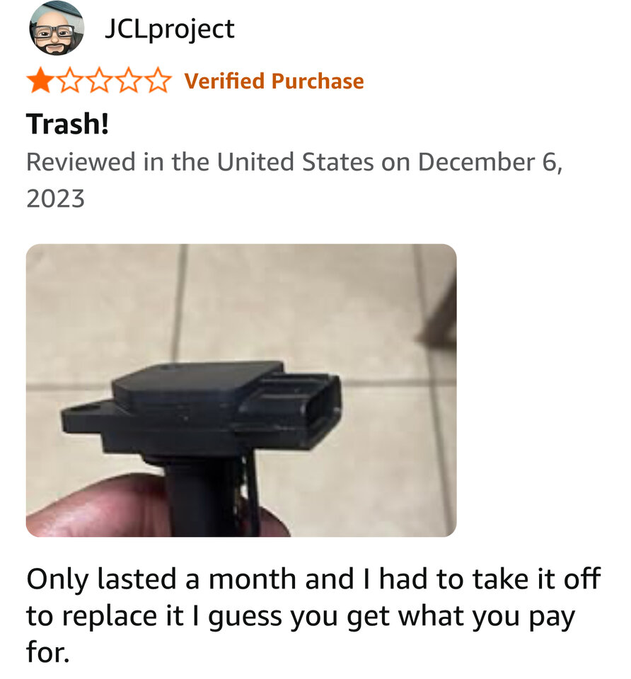

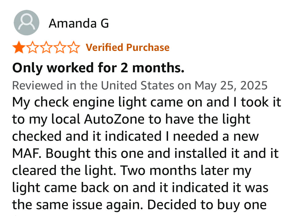

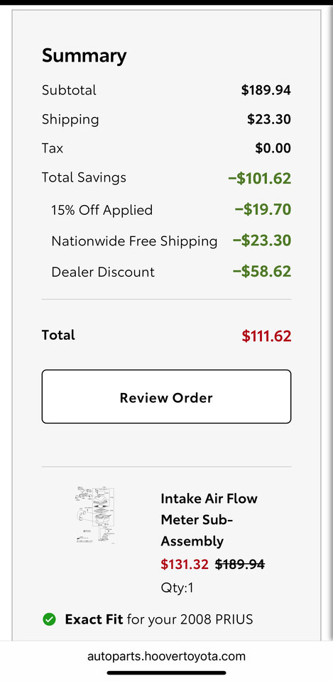

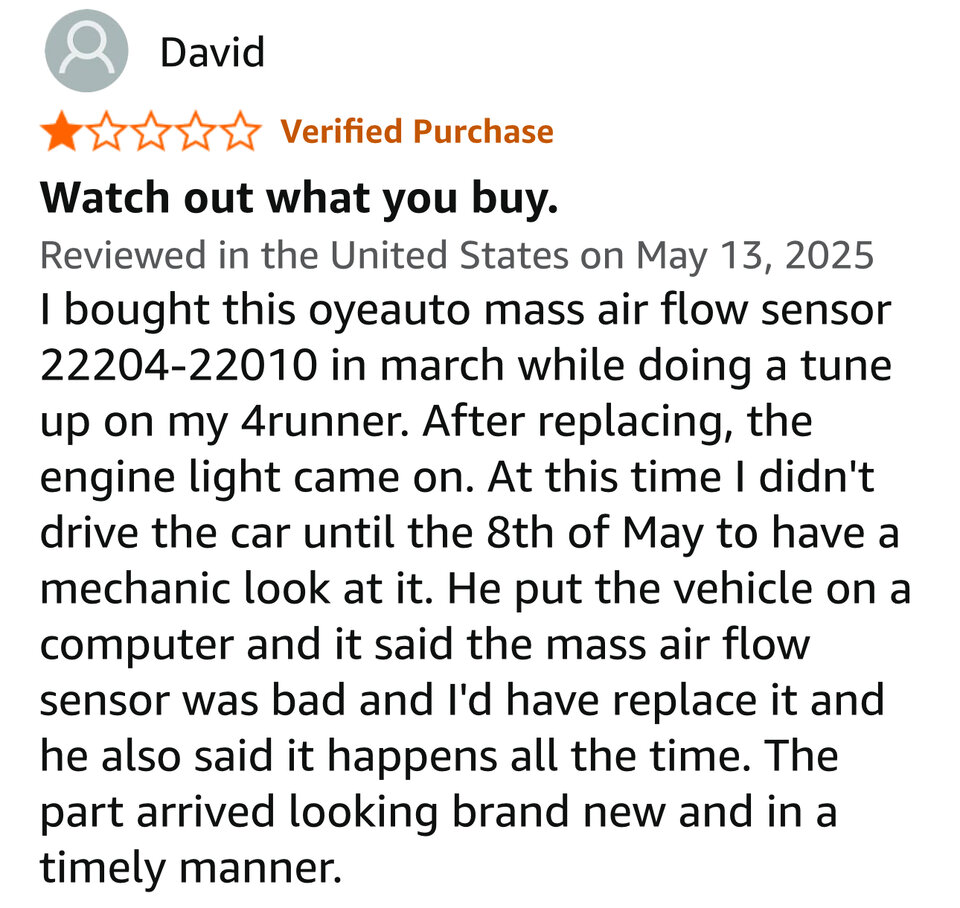

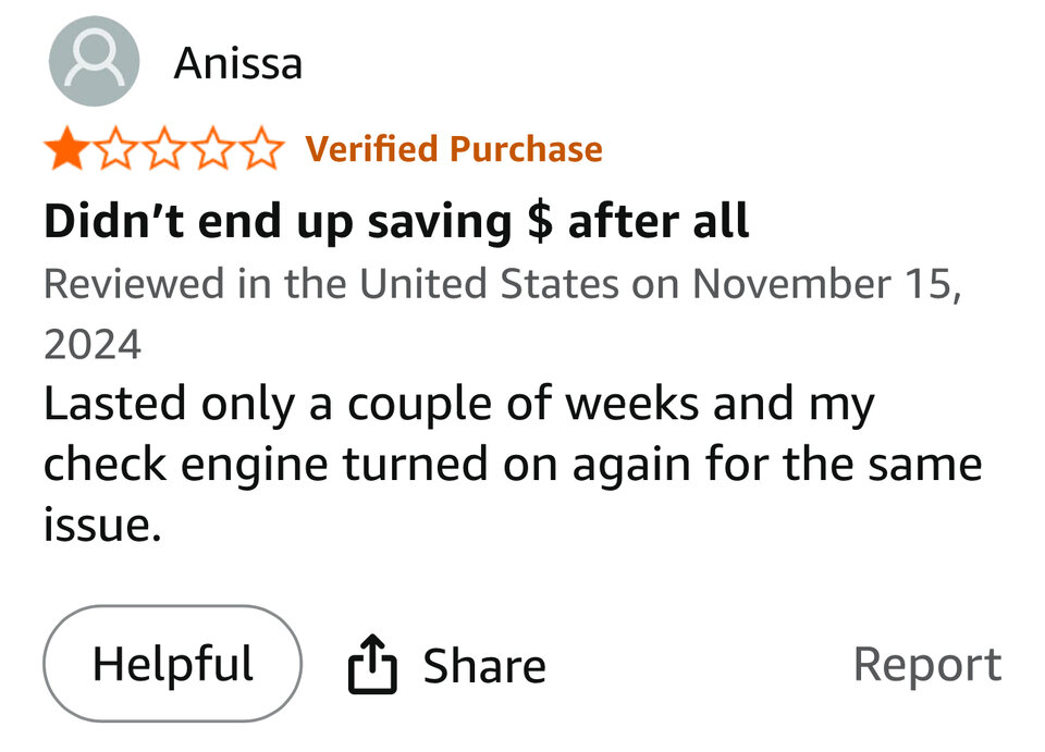

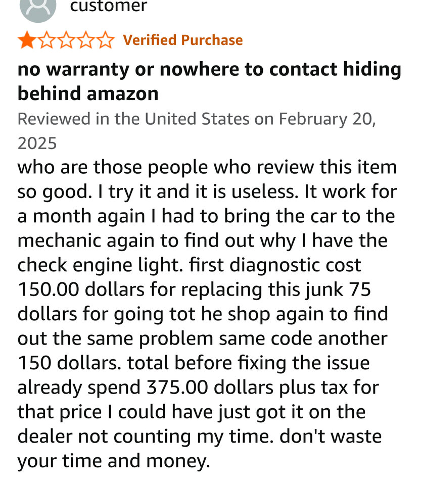

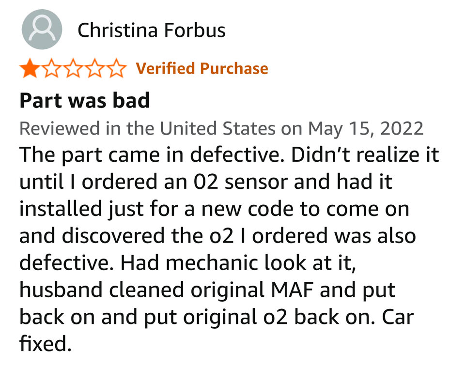

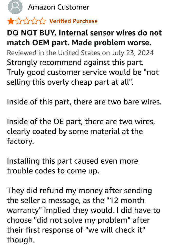

    Toyota or you will be sorry. Most get a few days to months out of aftermarket maf sensors before the fault returns and a mechanic diagnoses a bad maf sensor. Toyotas seem to be sensitive to maf sensor quality but most oem sensors last decades.
    Order online for $111 shipped to your door. Labor day sale from Toyota Corp and selected online Toyota dealers.
    Part 22204-22010
    A few reviews of a best selling aftermarket maf, remembering most buyers review immediately and not down the road.
