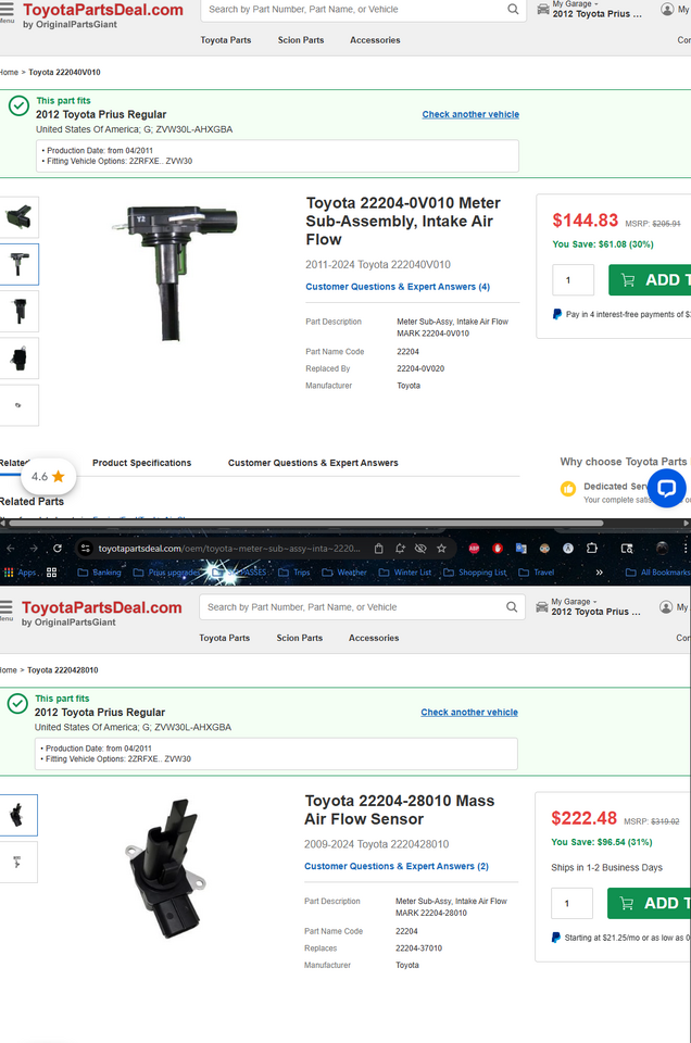

    Are these parts the same?

    Different part numbers, and different titles, different first model year, lots of differences? The MAP sensor on my 2010 has what looks like a small resistor at the business end, inside a little plastic cage. I dropped in on a guy doing an EGR clean in our neighbourhood (young guy, in his parent's driveway, sunny day about 0C :eek:), and when he pulled the MAP sensor it looked pretty much the same, except that "resistor" was nowhere to be seen, just an empty cage. IIRC it was a few model years ahead, say a 2013.

    it does say both fit a 2012 and they look identical. Since the headgasket replace my fuel economy has dropped 7-10 mpg to 34-37 while before the replace I was at 42-48mpg. Dr Prius tests at 60% and if it was the traction battery it would be a gradual decrease not a sudden drop. After some interneting a lot of the symptoms led me to believe the timing chain was off. I had a mechanic look everything over and it all looked good. Even checked the cat converter flow and that was good.
    After some back and forth dialogue the mechanic suggested it could be the aftermarket MAF and possible O2 getting close to be bad but was still in spec. The aftermarket MAF causing the issue made a lot of sense since mechanical everything had the thumbs up.
    So after all that I just want to be sure getting the correct sensor.

    I see the second one (22204-28010), a lot cheaper, on amayama, and it's indicated as compatible, for my Canadian 2010's VIN. The other it didn't like. Try this link, enter your VIN to check compatiblilty:
    Buy Genuine Toyota 2220428010 (22204-28010) Meter Sub-Assy, Intake Air Flow. Prices, fast shipping, photos, weight - Amayama
    That page also links to here:
    Air cleaner for Toyota Prius ZVW30L-AHXEBK, 04.2009 - 12.2011 - Toyota North America Car and Auto Spare Parts - Genuine Online Car Parts Catalogue - Amayama
    Best is start at Amayama main page and drill down. It asks for frame no, which can be found on same decal as the VIN (in driver's door frame).

    You seem to be talking about the MAP sensor (which, as I recall, does come in versions with and without a little doodad on the business end).
    But I think the OP is talking about the MAF sensor.

    I am talking about the sensor that goes in the air filter housing and has the mount holes/bracket in a diagonal orientation.
    I spoke with the local parts department and his thought is one is for Japanese market and the other North America market. However the computer did not say which was which. According to the parts diagram on Amayama they are all the same part. The lower price of amayama is tempting but with shipping cost and time there is not much difference, plus ships out of UAE or Japan and would like to avoid the hefty ballroom tax for the hefty doof in chief.
    Intake Air Flow Meter Sub-Assembly part# 22204-37010
    replaced by
    Mass Air Flow Sensor part# 22204-28010
    Meter Sub-Assembly, Intake Air Flow part# 22204-0V010
    replaced by
    Mass Air Flow Sensor part# 2204-0V020
