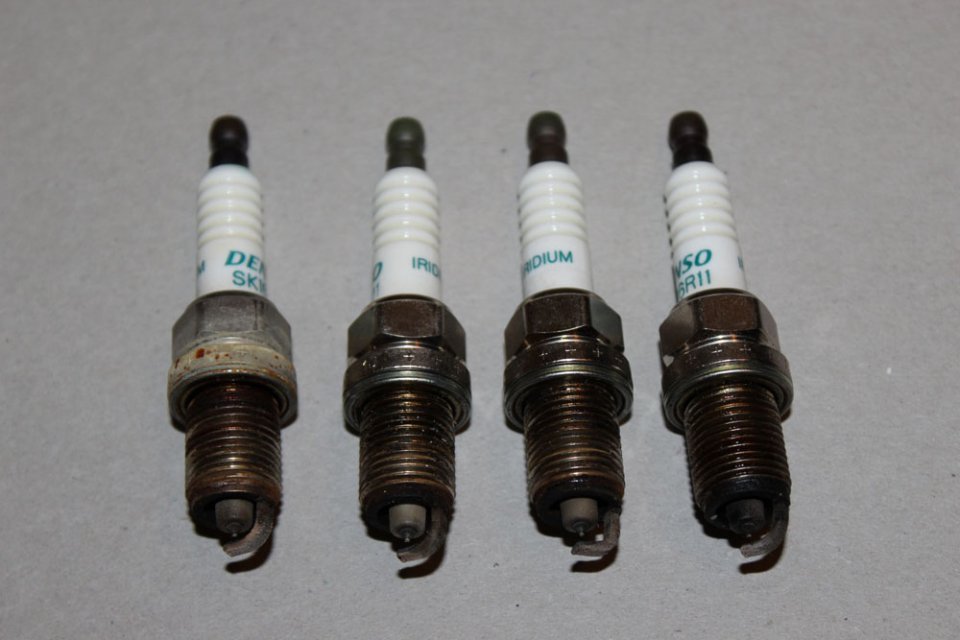

    sparkplug.jpg Thanks to all that have replied. I don't think it's a blown head gasket. The oil on the spark plug is not significant, but it is oil. I noticed it on the spark plug threads as well as around the tip area. It's not drenching in oil, but it's not dry like the other plugs I took out. Also plug #4 had rust on it, like water entered. I read on another post that this occur to another member and probably water just seeped into that #4 plug.
    I did replace the water pump and replace the coolant already. I don't know how long that water pump had been leaking but I can see coolant splash marks on the engine hood insulation cover (from the belt drive spinning the leaking fluid upward to the insulation cover). These marks were the initial evidence the dealer pointed out as the leaking water pump. I didn't think anything of the water pump leak as the car still ran perfectly, however the oil in the #1 plug was the concerning issue.

    Sounds like you've got a handle on it. Looking at the pics of the plugs, if you didn't overfill the oil, just keep an eye on oil consumption and your exhaust. If there's no smoking or rough running, probably not any problem in that area.
    Might check posts on water buildup on the cowl below the windshield. That could have caused water to run on and pool around the one rusty plug.

    Thanks for your insight. I believe there could be a chance my mechanic overfilled the oil. I normally bring him 4 quarts of oil and he puts the entire amount into the engine. If the plugs are fouling with oil due to overfill, then I can correct this issue by just putting 3 1/2 quarts in the future.

    Australia
    Yep that's an overfill right there.
    3.5 quarts is a pretty safe fill, as long as you've properly drained. Just check the dipstick, anything near to full but not overfilled is perfect.

    I just pulled my dipstick to check the level and it doesn't show it's overfilled. It's right at the top of the full line. Unless this car is consuming oil, 4 quarts seems to be correct.

    Australia
    Yeah, it's using oil, that's why your plugs were oily. When it's overfilled it seems to use that excess oil relatively quickly. That's what actually causes the problems.
