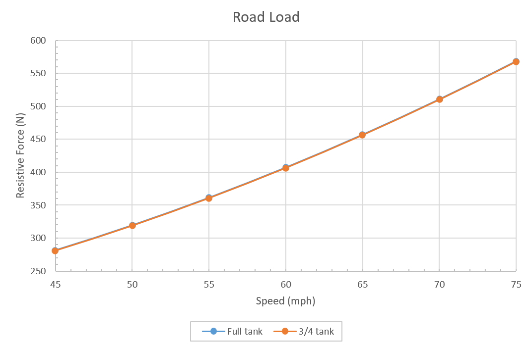

    I just plotted the data for rolling resistance + aerodynamic drag; the blue line is a full tank (using Toyota's listed curb weight plus a 150 lb driver); the orange line is 3/4 tank, 18 lbs lighter. This is the difference in force that must be overcome for a given steady velocity:
    It will make more difference in stop-and-go driving. But 18 lbs isn't much.

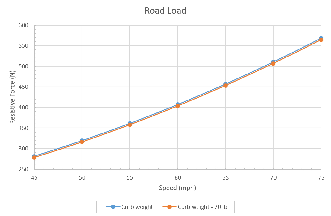

    Request for 70lbs reduction graph please, thanks.

    My aviation training was that gasoline weighs about 6 pounds per gallon (less than water), so the weight savings of keeping the tank 3/4 full would be just 3x6=18 pounds.

    Great plot. Thanks. I believe it. To me it shows the obvious - that MPG is highly dependent on speed, and comparing anything without factoring out that effect can easily lead to doubtful conclusions.
    One possibly useful interpretation from this, just eyeballing the plot, is that at highway speeds, dropping 70 lbs gets you the same MPG gain as slowing down by about 1/2 mph. That may be a useful factor to consider while stripping your car to the bones.

    Ok, spreadsheet time. Considering, full capacity is 45 liters, and you fill up when the tank is down to 1/4 full, then the average amount of gas you're toting is 5.625 liters less. Considering gas weighs slightly less than water (and a liter of water weighs a kilogram), on average the car weighs say 5.5 kilos less, or about 12 pounds.

    Gasoline is only about 75% as dense as water, so only about 9 pounds average difference, as I pointed out in an earlier post.

    5.625 (kg, if water) * 0.72736 * 2.2 = 9.00108 (lbs, of gas)
