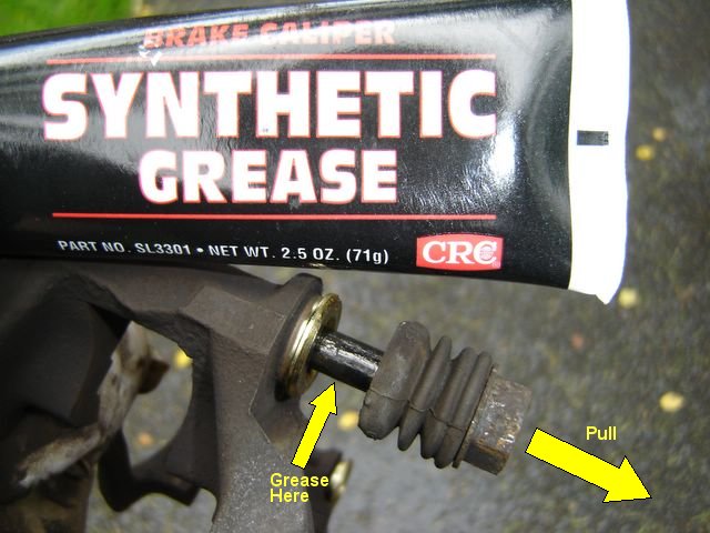

    Ummm.... no they don't. Lithium grease is the wrong grease for the pins and boots because it is mineral oil based and will cause the rubber boots to swell, interfering with the free movement of the pins and causing the brakes to drag resulting in heat buildup, lower MPG, and increased rotor and pad wear. The boots and pins require synthetic grease.

  13. NavyLCDR
    NavyLCDR Active Member
    Oct 15, 2016
    202
    127
    Lebanon, OR
    2024 Prius
    XLE AWD-e
    Just do not confuse what is in the manual with this:
    That is the WRONG grease.
