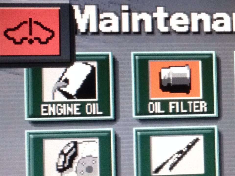

    Hi everyone!
    Hope I have the right forum for this question.
    I just bought a 2005 Prius with 69k miles on it in January. The car had all scheduled maintenance done prior to my buying it. i immediately had the oil and filter changed within the first 1k miles I put on it. Used a synthetic blend oil and had it done at a Valvoline place I've been taking my Toyotas to for a long time.
    Today, right after I started the car, the red triangular shaped alert with the exclamation point came on. I went to the "maintenance" button on the panel and it showed the oil filter icon in orange. I'm still on a learning curve with this car, but I take it that means it's time to get an oil change? It should be good for at least another 1-2k miles based on the oil I used. It's currently at 74k miles. Should I be worried about this or does this light always come on when it's time for a change?

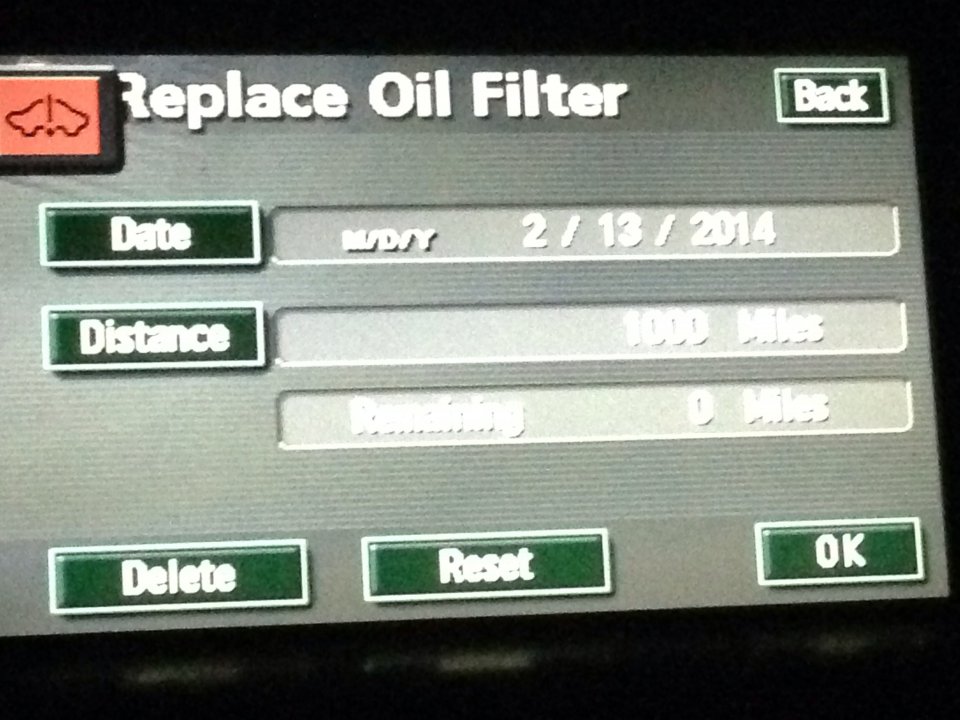

  3. priusnewbieneedshelp
    May 13, 2014
    Maybe these photos describe it better. So basically I just need to reset the button myself next time I get it changed?

  5. fuzzy1
    17,922
    10,706
    My GenIII is different than your GenII, and has different reminders, so I'm not the best person to answer this. Did your used car come with the Owners Manual?
    I found a couple threads indicating that some GenIIs can have a variety of custom reminders pre-set by the driver or shop. (Our new Subaru also has this.) Here are the first relevant threads I found, one here on PriusChat and one elsewhere. Notice the picture in the first thread, and the reset instructions in the second.
    Oil filter warning
    Toyota Prius Warning Light?
    While I'm believing this is strictly a mileage-based reminder set before you acquired the car, this is also a good reason to follow JC's suggestion and do a complete check of fluid levels.

    You have the Hybrid System Warning light on in the MFD. The red car with exclamation point. This is the important one.
    Has nothing to do with the engine.
    That will throw the red triangle which is the Master Warning Alert on the dash that's used to get your attention that something is very wrong
    and needs attention.
    You need to get the Hybrid trouble codes read read that the car has stored. These must be read by a Hybrid capable code reader. They don't use those at the free autostore check. Dealer charges $125 to pull the codes. Post those codes back here including its sub codes= XXXX-XXX
    Usually its a bad hybrid battery that has a soft module or 2. Is the hybrid battery on the consumption meter making big swings from full to empty fast and is the battery fan in the backseat coming on?
