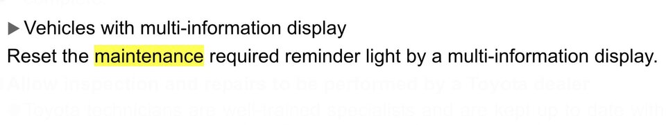

    If this procedure works on the refreshed 2015 v you have to be in trip A before powering up in Ignition mode (two presses of power button without brake) while holding the km button for a few seconds.
    Video of reset method on v without km button
    If your refreshed Prius v has a MID screen in the main top display, then it's done there. This is the case on later model Toyotas.

    I tried several times with those different methods, but none of them worked. I started looking through the heads up display menus and found the gear icon, then a maintenance menu, and there was an "initialize" option. I did that, and it went away.

    Good deal. The multi information display reset option is only mentioned in the 2017 v manual which adds confusion for the 15-16 v owners.
