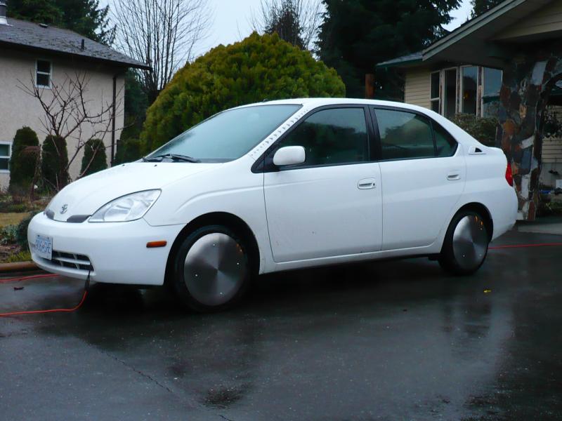

  14. orange4boy
    orange4boy Member
    Oct 20, 2009
    231
    44
    Vancouver BC
    2003 Prius
  15. B. Roberts
    B. Roberts Hypah Milah! Ayuh.
    Mar 11, 2005
    691
    212
    used to be "Glacial" Maine and now FL
    These are the best aero covers I have seen yet. One question about them, is there a way to cut a round accest hole for the tire valve? That would make it easier to check and maintain tire pressure without dismounting the covers each time.
    I am interested.
  16. gge5
    gge5 New Member
    Jan 4, 2007
    31
    Corvallis, OR
    Thanks. Yes, before I had them painted I had to drill the rivet holes for attaching them to the trim rings. You could just as easily drill another hole for access to the valve stem.
    One thing I would do differently if I re-made these is I would paint the trim ring black before I attached the disks. It goes from the black of the wheel rubber to the red of the disks with a silver outline from the original trim rings.
    By the way, I got two compliments on them just today. One girl pulled up in a turn lane at a stop light and the guy in the passenger seat was waving his hands to get my attention. He asked me if I made them myself. Another guy commented them on them after I got out of my car. This is definitely the mod that stands out the most. You can't do this on any non-hybrid car.
