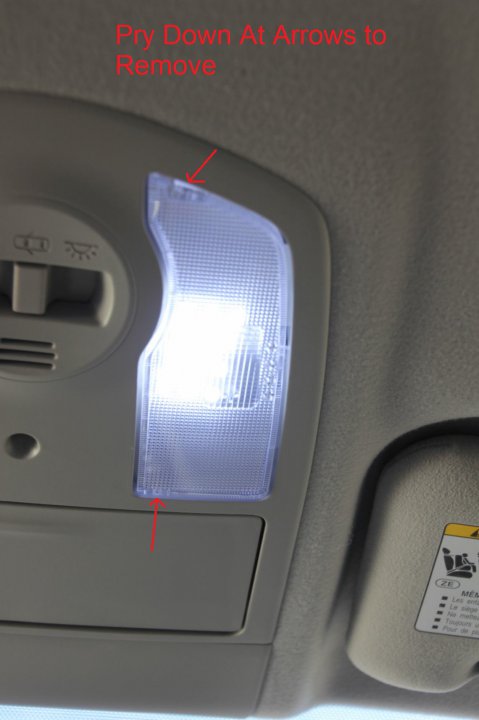

    Just got led interior lights to replace the stock interior lights. I can't get the map bulbs out! I have the solar package. Any tricks that I am unaware of? Thanks!

    If it's like mine...

    Thanks! I finally got it, I had to use some padded pliers.

    A trick I always used taking those small bulbs out w/o damaging them is to wrap tape(scotch or electrical tape) around the bulb and pull.
