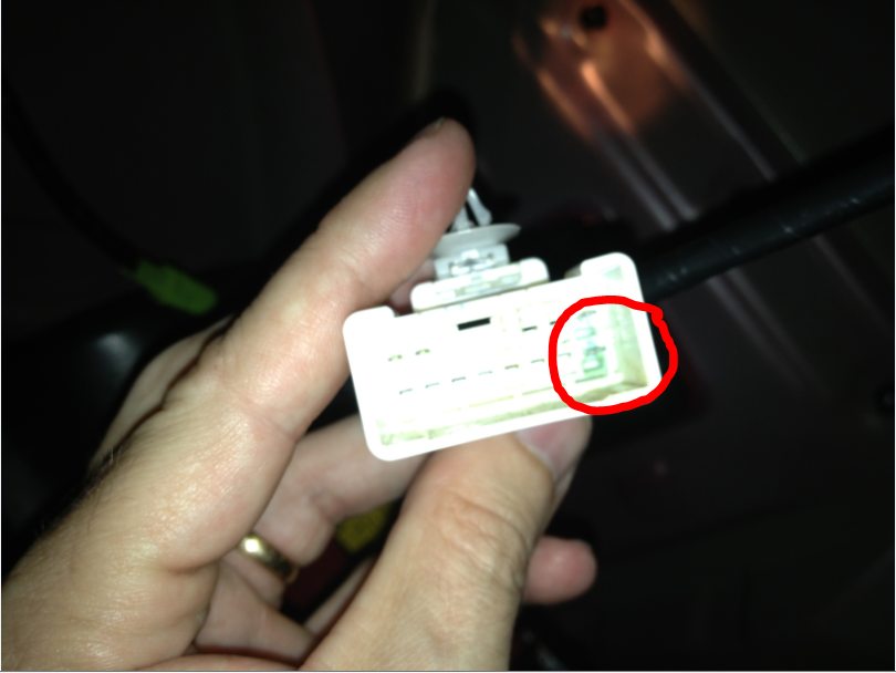

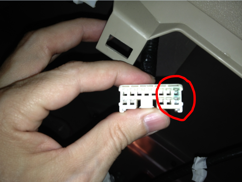

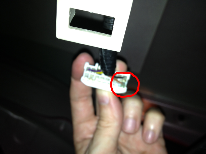

    I hope I have found the problem. I believe the water issue is related to the fan no longer working. Attached are 4 pictures showing corrosion on and in the plug that sits above the fan assembly secured to the body. The leak seems to be up high, possibly at the bolts that secure the hatch pistons to the body. Water then drips down (both sides of the body) and is what caused this. Anyone have experience replacing the connectors instead of the entire harness? 04 Prius Harness_Plug_4.PNG 04 Prius Harness_Plug_3.PNG 04 Prius Harness_Plug_4.PNG

    E-mail Plug In Hybrid Electric Vehicle PHEV and ask for a salvaged connector with all wires still attached. If they have one then all you have to do is to cut off the bad connector and splice the wires. Good luck!

    As a quick work around, since you will need to cut wires anyway, is to cut the two trouble causing wires on each plug, and jumper over them with butt splices. It may be a long time before you are in there again, and you can splice in the good plug later.
    Patrick Wong likes this.

    I agree that splicing the two faulty connections (four wires) is the best (and cheapest) approach given the circumstances.
