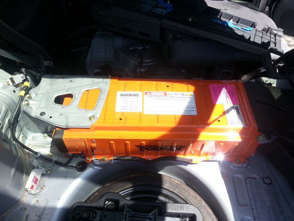

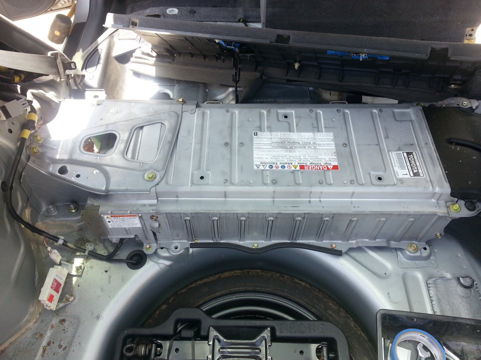

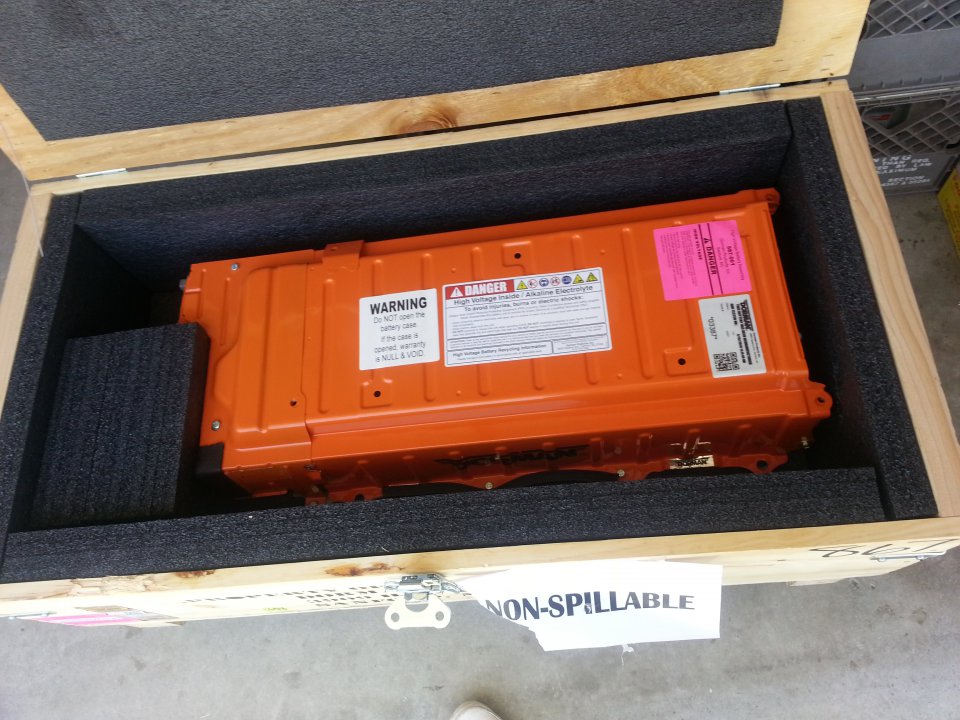

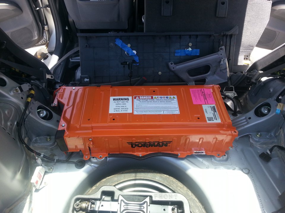

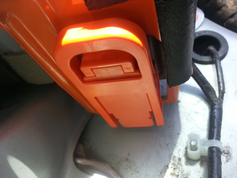

    Here are some pictures of the old and the new Orange painted Dorman battery.
    #23 kimseongjae, Jun 14, 2014

    Congratulations on a job well done. Lots of good simple trouble shooting involved in this thread. Excellent work.
    I don't think Rockauto is in CA or they would've taxed you on the order. and $52 for delivery on over 100lbs is really cheap. Is the shipping charges included in getting the core back to them?
