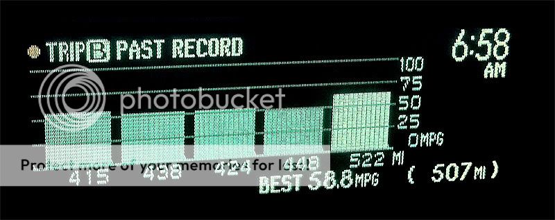

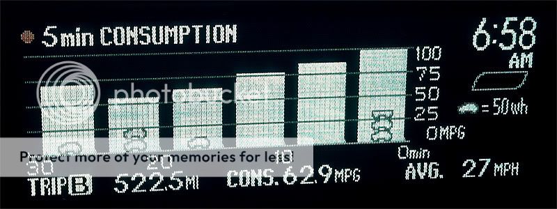

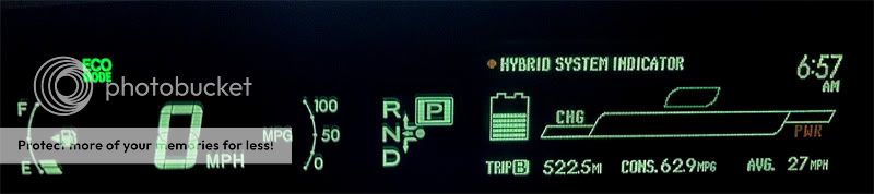

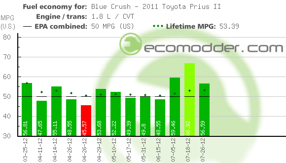

    Alright, I'm home with my results from this tank. Keep in mind I started using N to coast at about 100 miles into the tank or so.
    HSI Display
    Can somebody explain this display to me? Are the little cars energy used or generated?
    Priors
    Overall MPG per tank calculated
    Thoughts, opinions, questions, comments?

    I see that you are at an average of 58.8 mpg in 13 tanks of gas, which is really high but you also live in Nebraska, there are no "flat" roads here in NJ where I live. If I'm not going up a hill, I'm going down one. There are more police out than most other states as well, thus making it difficult to drive with load, or use other techniques which require additional speed to cover the next steep hill.
    The hills I encounter are all steep enough that driving up them at full eco bar the car can only get going 16 mph, if I have a running start, 33 down to 18. This is not conducive to good mpg obviously.
    I've watched the videos with people attempting to hyper mile and read the tutorials on maximizing mpg on these cars, and gliding works well for people with gentle inclines and long flat stretches, or city blocks where it's easy to keep the car in D and blank out the HSI display to roll between close stops.
    As a local comparison, my friend has a gen 2 and averages 42 mpg on the same roads as I'm getting 10 more mpg using all the techniques known. I have excellent pedal control as I've been racing cars and motorcycles for a decade and can keep the HSI display blank even over bumps, but I just could never get over my previous best of 55 mpg. This tank got me 59.51 which is an improvement, if there is some other way to obtain this mpg every tank please do describe it in detail because I am always willing to try something new, or tried and true.
