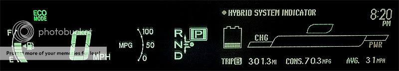

    Hey everyone, I'm home.
    To Mark, yes I consider split second maneuvers and I'm not saying that I am bionic, but for a decade I've driven nothing but stick cars. Shifting to drive, shifting to race etc has led to me having a keen ability to execute gear changes faster than the average driver. With this car being auto and my hand constantly on the lever it's just as easy, if not easier.
    As an extra safety measure, I do not play follow the leader on the streets. From motorcycle riding I've adapted my field of view from riding the bikes to driving my cars. Look ahead, way ahead. Unless it's an animal, or someone speeding running a red light that I have no control over I have been fortunate enough to have plenty of time to stab brake and avoid close calls.
    The first day I bought this prius, I hit a deer for the first timee in my life. I was in D going about 45 in 50 zone and my best maneuver was no match for the deer who stopped, watched my reaction and ran directly into the front end of my car. I drive more cautiously than ever before on that stretch of road for that reason.
    As for an update, here is where I am at after almost half a tank. I would have reported sooner, but short tanks aren't proof of anything. This is the real deal, 300+ miles is enough miles I feel to demonstrate that what I'm doing is legitimately working. 70+ club on the display

    And yes, I am ok with meeting in the middle, as I do both D glide and N coast so there are advantages to both as mentioned it is really situation specific. I've found a way to use it to my advantage and I'm just exploiting that, I hope to encourage everyone to always strive to break their previous records.

    Very nice! Especially for a Prius newb! ;) Thanks for trying new stuff and convincing me to do the same.
