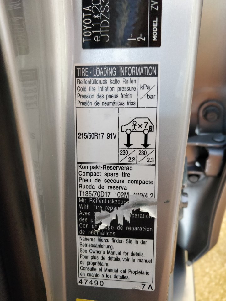

    There is no letter prefix in the ISO-metric standard. There is a P prefix in the P-metric standard. According to your tire placard, you have 215/50R17 ISO-metric tires with a load index of 91, as there is no P prefix, and the 230 kPa = 33 psi pressure shown is for ISO-metric tires of that size.
    The load and inflation manual explains in detail the procedure to find the correct tire pressure if you change the tire standard (such as from ISO-metric to P-metric) or tire size. In your case, if you change from ISO-metric to P-metric, your pressure would be reduced about 2 psi from 33 psi or 230 kPa to 31 psi or 215 kPa.
    You basically look up the pressure (33.4 psi in your case) and load index (91 in your case) for your original tire to find the corresponding load. You then go to the table for the new tire and find the pressure corresponding to the load you calculated for the original tire for the new tire standard, new tire size, and new load index. You need to look up the correct table and be careful because there are standard vs. reinforced tires and load indexes also vary. You will also need to do some interpolation. Refer to the load and inflation manual for full details.
