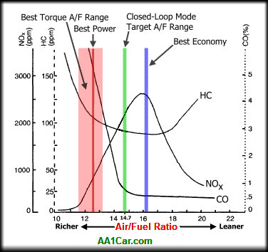

    There have been decades of myths around lean burn, so let me explain.
    The hottest burning AFR is stoichiometric, pure and simple. Stoichiometric is too hot at full throttle. You see, as you go leaner or richer from stoichiometric the combustion temperature lowers. What makes an engine "too lean" is one that doesn't enrich enough at full throttle, as gasoline engines typically use a rich mix for detonation mitigation at high loads. That "too lean" can be stoichiometric or just above or just below it.
    Another technique that has been used to avoid detonation is actually running much leaner than stoichiometric at full throttle. Contrary to popular belief, it can and has been done before and has worked just fine without causing detonation. But the main problem is this doesn't give you full power, whereas a rich mix does. And the second is that it makes it hard to get rid of NOx.
    You actually get a lot more NOx formation in a stoichiometric, or slightly leaner than stoichiometric homogeneous gasoline engine than a true lean burning engine, including diesel engines, as stoichiometric engines burn much hotter. But the homogeneous mixture means there's enough left-over fuel to use to react with the NOx and reduce it down to levels lower than a lean burning engine.
    Adding EGR further reduces the initial formation of NOx. EGR and lean burn are very similar, in that you are adding a inert gas to the mix (air without fuel is inert too), which both give you benefits in reducing pumping losses. You'll also get similar NOx formation in both a lean burning and an EGR fed stoichiometric engine. The problem is that the EGR fed engine will tend to do what stoichiometric engines do and have lean and rich pockets that don't burn up all the fuel leading to lower efficiency, whereas the lean burning engine will have little to no fuel left over that can react to the NOx that formed.
    And this applies whether it's a gasoline engine, a diesel engine, a propane engine, a CNG engine, etc. The only difference is we can't make a homogeneously mixed stoichiometric diesel engine, so all diesel engines are lean burning. But at any rate, lean burning gasoline engines and diesel engines have many of the same advantages and disadvantages.

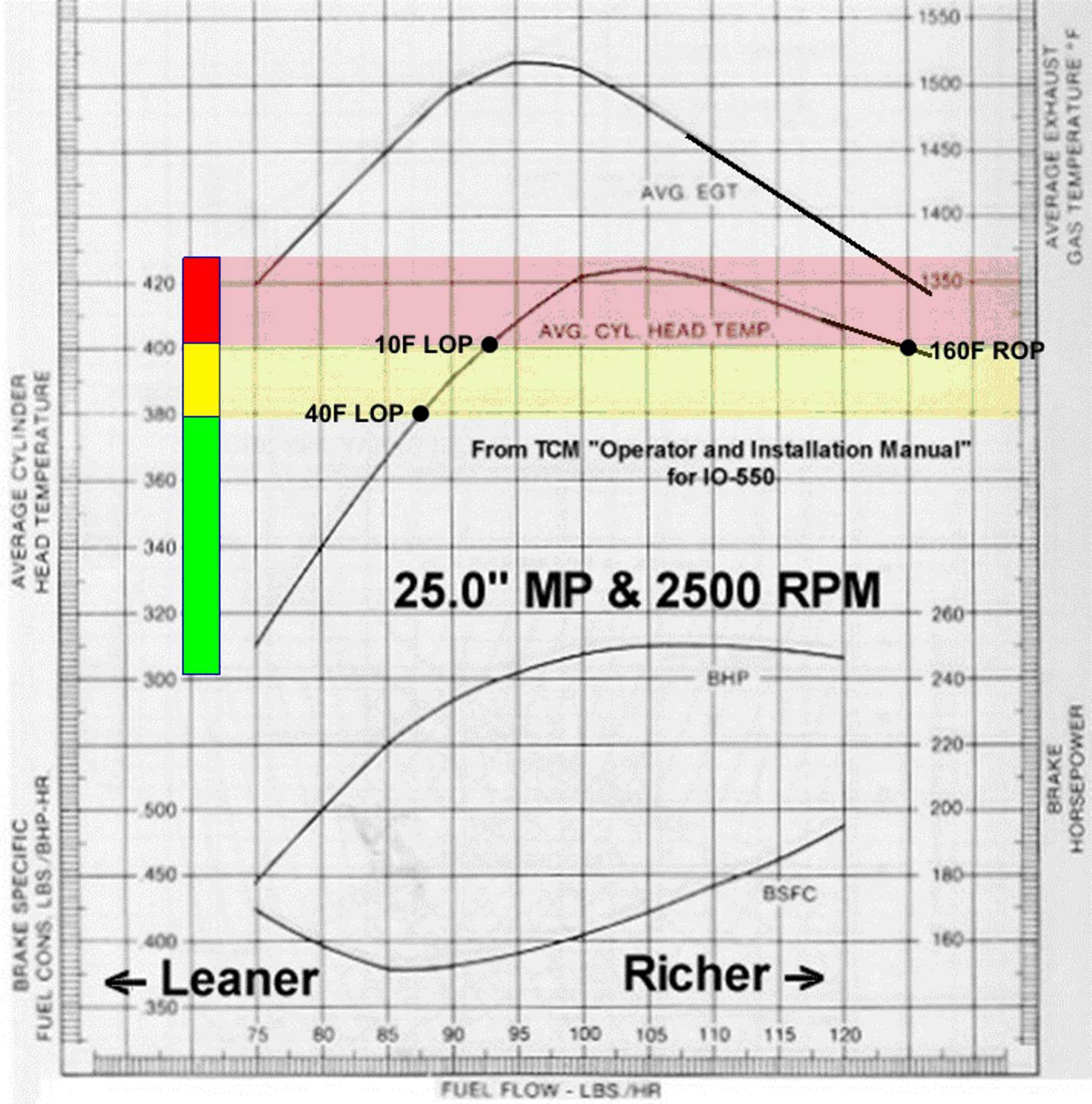

    Except that it's not a myth, based on my experience flying airplanes. There is a mixture control, which controls the fuel/air ratio for different altitudes, and a cylinder head temperature gauge (in the planes I have flown). The procedure is to lean the mixture as you climb, limiting the leaning mixture by the cylinder head temperature, which increases with the leaner mixture.
    I saw the video declaring it a myth, but it was using specious arguments, not unlike a flat earth dissertation. A rich mixture cools the combustion chamber by vaporizing unburned fuel.

    And what were your AFRs exactly? 15:1 is still very close to stoichiometric.
    A rich mix does cool the combustion chamber by vaporizing unburned fuel. A stoichiometric AFR doesn't have much of that effect. Slightly leaner and you also are still very hot. But down below 16:1 and the temps cool off as the air is inert and only cools the combustion. It's the same principal as EGR, which also cools the combustion event.
    I also did experiments of this type in a 1972 air-cooled VW Beetle. I could run as low as 17:1 and saw both lower head temps as well lower as oil temps. I drove all over as a daily driver with it setup to rise to 12:1 at full throttle and lower to around 16:1 to 17:1 at cruise. I had zero detonation issues and zero overheating issues.

    If lean gasoline engines can't control NOx formation in the cylinder, then the 3 way cat is going to need help using emission tech from diesels. Mazda might have got it working in the SkyActiv-X, but the efficiency gains they first claimed ended up being half. It also never came to the US, which has stricter NOx limits.
    A common chart showing emissions in relation to air/fuel ratio.
    It is a myth. One that started when carburetors where the only option on cars. The factory setting for the fuel trim wasn't at 14.7:1, it was slightly rich. People would then turn the screw to lean the mix, but they were stopping at stoichiometric and not getting into actual lean ratios. When things broke from too much heat, they blamed the fuel trim as being a lean mix, when it was because they removed the cylinder cooling of a slightly rich mix.
    As for planes, "Both automotive and aircraft engine carburetors contain devices that effect automatic mixture ratio changes. However, these devices function in relation to power ranges and are not sensitive to air density changes."
    The Fuel Air Mixture - AOPA
    As altitude increases, air density drops, which leads to less air in the engine cylinder. The air/fuel ratio becomes too rich, so you reduce the fuel trim. However, you did not make the ratio lean. With less air in the cylinder, less fuel is needed for the 14.7:1 ratio.
    The chart doesn't give the stoichiometric point, but it clearly shows that cylinder temps drop as the air ratio gets richer, and more so with leaner. Temperatures increasing with reduction in fuel trim, means the ratio is returning to 14.7:1 from a rich mix.
