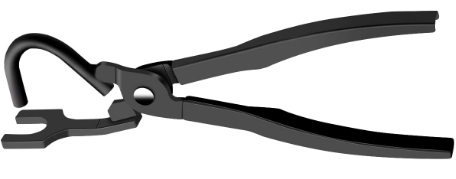

    I don't have one of these, believe the usual name is "Exhaust Hanger Bracket Removal Tool". Looks like this:
    Used for pressing exhaust hanger hook out of the rubber support grommet. They're about $20~25 CDN on Amazon.ca for me. Definitely not a must-have, for me but...
    Then, considering how often I might ever need it, the cheapskate in me says maybe make something, say like this, plywood scraps, dowel and fastener hardware:
    (Maybe sub wing-nuts for the regular nuts shown. Use carriage bolts, with square shoulders, to lock the bolt from rotating.)
    (hopefully not so bulky it's unusable)
    (probably close to $5 for all the hardware alone, lol. But I like a project.)

    Last time I was under there, I saw one of the rubber hangers was partly backing itself off one of those pegs. I have no idea how that happened. So I had to improvise something to mash it back on. I don't remember exactly what I used, but I don't think it was very elaborate. Something like one of the bar clamps lying around for woodwork, and maybe a socket.

    Channel lock pliers will work, not ideal, but...
    Plus a little silicone spray, let it sit a while.
    But now I want that tool, lol.

    Clever tool. In our shop, we just use the "Armstrong method." It involves a large screwdriver and some brute force. Having replaced a bunch of stolen cats by now, I've gotten pretty adept at prying off the old hanger in just a few seconds and jamming on the new. We also use shorter rubber hangers when installing a cat shield so the cat won't rattle against the shield.
