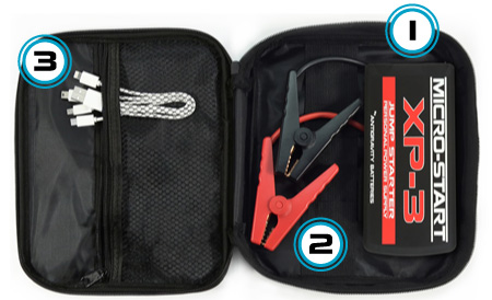

    At the other end of the spectrum, because I don't need such a beast, this will stow in far less space.
    (They've refreshed this model a couple of times; I have an older version.)
    It's only 29.6 watt-hours, so a little better than a seventh the capacity of the sealed-lead-acid beast. But it's also 10.5 ounces, not 15 pounds, and takes a fraction of the space.
    (Hmm: if you looked at the advertised amp-hours for this (8000 milliamp hours, or 8 amp hours), compared to 17 amp hours for the beast, you'd think this was more like half the capacity, not a seventh. But here they are advertising the milliamp hours at the voltage of a single lithium cell, 3.7 volts, not 12. Marketers, you can't take your eyes off 'em for a minute.) This is nearly their smallest model, so bigger is definitely available. This has been adequate for starting Prii and even some random family's old rundown van once. They thought I was joking.
    Of course these are more money compared to the lead-acid versions. But the compactness and low weight are nice.
    I suggest going name-brand with these (this link is one of the better-known brands) just because you don't really want a big off-brand lithium battery riding around in your car with you. These guys use UL-listed batteries. For similar reasons, be cautious buying from sources other than the maker's web site; Amazon was reportedly selling counterfeits of them ... again, scary when it's a lithium battery in your living or driving space ....
    Edit: You can see the clamps use just 10 AWG wire. But they're also less than a foot long. For comparison, if you wanted to make 16 foot cables with the same resistance, you'd have to use 3/0.
