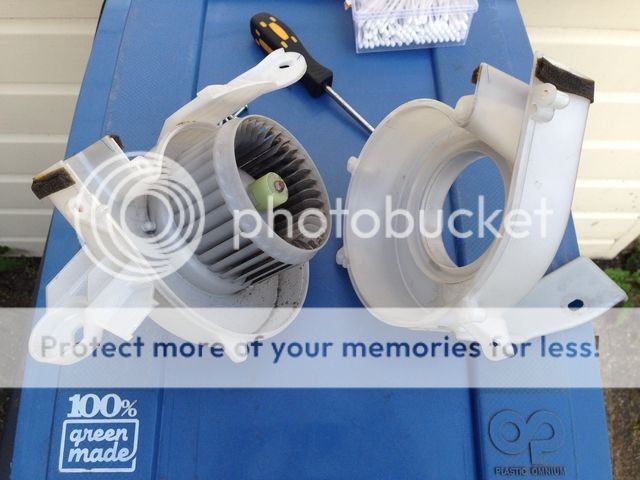

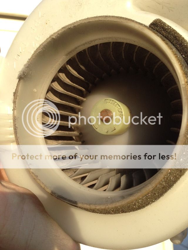

    This evening was lovely warm and still, OH doing some working from home so I was free (you know how it is) to do as I wanted. That HV battery ventilation fan was calling me so I pulled some trim off and had a chat with it, the dirty little thing...
    Around 8 years and 207,000km's worth of schmutz:
    Split in half:
    Job done:
    Dead easy job, I'd recommend doing it if you haven't done it before.

    As for the fan cleaning, this evening after changing the oil I went for a drive and for the first time the sound of the fan running. Either I was subconsciously listening for it, or it is actually louder since being cleaned, I'm not sure. Suspect the latter; less filth = more air flow = more air flow sound.

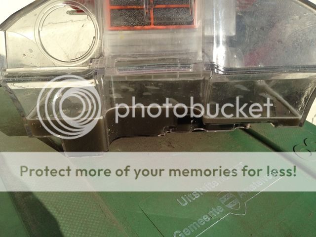

    Yesterday I had the urge to excercise our carpet cleaner so set to work on the Prius. It doesn't look a huge amount cleaner but does smell a bit fresher. Despite this only slight visual and nasal (?!) improvement, the dirt which came out was pretty shocking.....
    Sorry if you're having your dinner :eek:

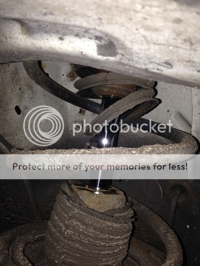

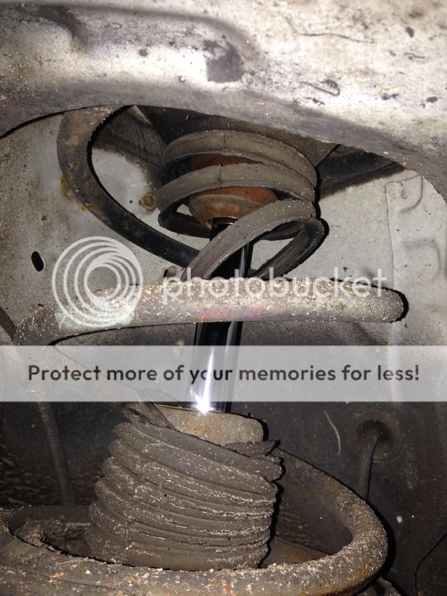

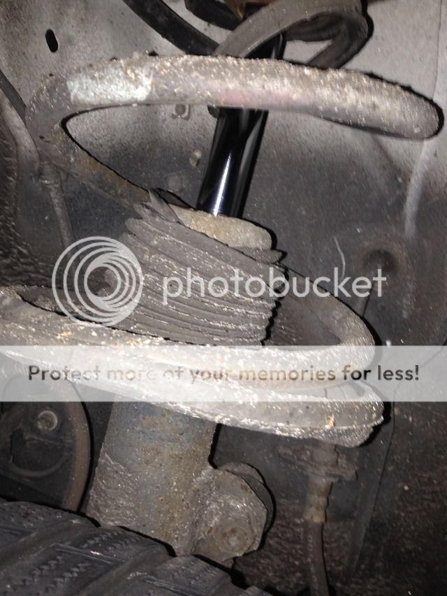

    The temperature here is due to drop suddenly in the next days so today I swapped from summer to winter tyres. Whilst under the front left wheel arch, I found the protective sleeve over the strut to be broken and so exposing the strut.
    Is there a way to replace this cover easily? Or maybe even.. "easily"? I suspect not and suppose the whole strut and spring will have to come off, spring compressors used to take the top mount off... and so on. :-/

    Yep, just like replacing the strut. If you're going to go that far, check the strut for replacement. Also, the top mounting bearing, mine was a little stiff and caused my steering input to be less than smooth.
    The work is no different than any other vehicle, just time and a wheel alignment afterwards. Good luck.

    No action taken on the rubber strut cover yet.

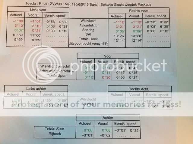

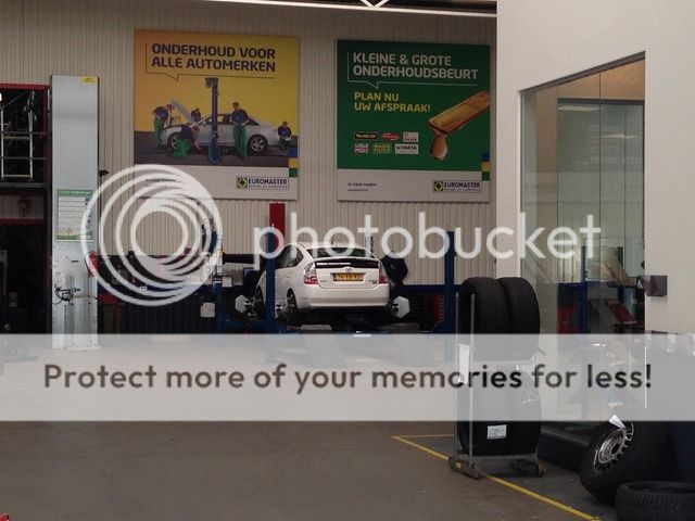

    Since I've had this car it has felt like it needed the alignment done. It doesn't pull left or right but the steering wheel doesn't sit straight and at full lock it doesn't want to self centre.
    As I write this, the car is up on ramps at a local Euromaster having the job done
  12. Melchior
    Melchior Junior Member
    Feb 16, 2015
    74
    21
    Netherlands
    All done, the results are in. They told me it was WAY out. Maybe it's had a bump in the past, or suspension work without alignment afterwards. It feels a bit better now but I only drove it half a mile back to work so far.
    Odometer reading is now 221020 km.

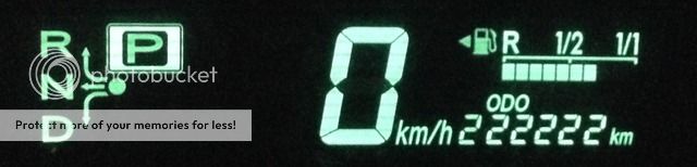

    OCD ODO achieved yesterday.

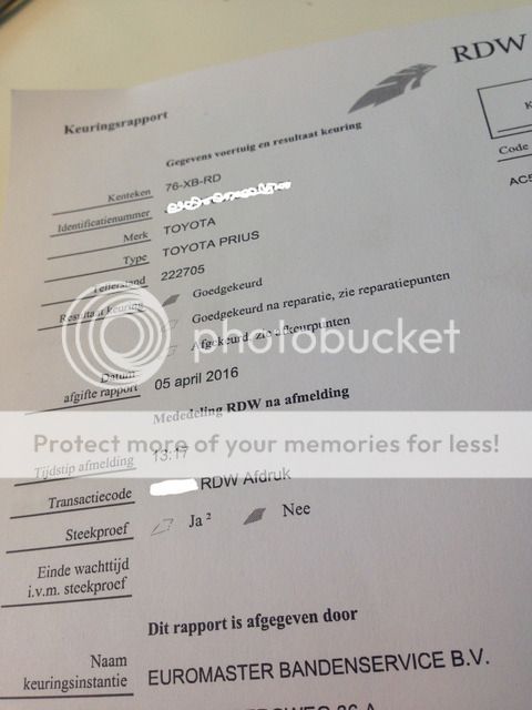

    APK test today (Dutch version of the English MOT, German TÜV... a yearly safety etc. inspection)
    Passed with no issues, the tester did mention the rear pads are getting low. They'll replace them for just under €100 but I figure I'll have a look for myself when I swap to summer wheel/tyre in the next few days. If it looks like there is a decent amount left, I'll re-check them in 6 months when I swap back to winters.:)
