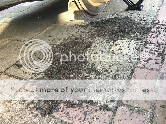

    Since owning cars for about 16 years or so, I have never bothered to rotate tyres. I used to be such a hooligan that tyres didn't long long enough anyway :eek: but I keep reading on here that one should and as I had some golden free time, I went ahead. Lo and behold, what did I find?!
    Mud, for starters. Quite a lot of it! Mostly behind the lip of the wheel arch.

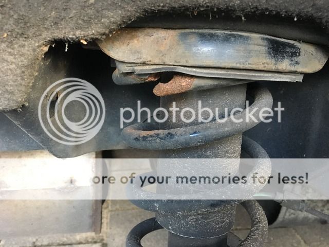

    And for fun, a broken spring.
    Judging by the rust on that, it hasn't broken recently. It passed its APK last year with no mention of this (obviously, it's a fail. The tester did however mention the low rear pads which, almost a year later, are still not low enough to need changing...) so either they missed it or ignored it?!
    They look pretty easy to replace so I went online and bought a pair of Monroe springs for something like €45 each which is a very good price. The spring on the other side is OK but with suspension parts I rather replace them in pairs. For a brief moment I considered lowering springs (there's still some of that old hooligan in me) but managed to get a grip and remind myself why I'm running this car.

    - Rear spring replacement was done, quite an easy job. Car sits a bit higher at the rear now
