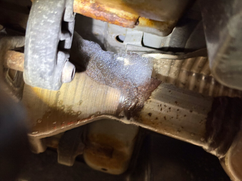

  8. shaltbecome
    shaltbecome New Member
    Jan 22, 2026
    Louisiana, United States
    Looked under the car today since I had P0420 and a strong exhaust smell. I found two exhaust leaks - one at the exhaust donut and another where the back of the catalytic converter connects. I also found a few rocks on a bracket near the catalytic converter (didn't take a photo but I think it was unrelated). I watched a few videos of gen 2 cold starts and I think I hear the same sound as my car it just seems to be quieter so maybe the exhaust leak is making it louder?
  9. saneesh8
    saneesh8 Member
    Jul 5, 2024
    231
    Allen, TX
    I guess fix all of those first and it should take care it.Exhaust leak can make it louder for sure.
