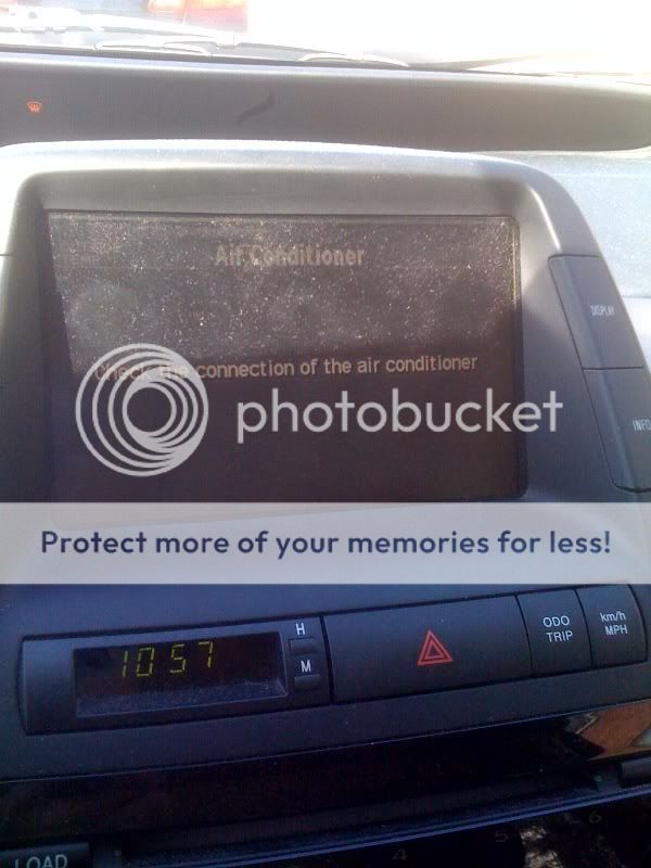

    Thanks to Hobbit for the investigation into this issue and to patsparks and many others for the encouragement to fix the solder joint myself! A couple weeks ago (at about 86,000 miles) my MFD started acting up with the previously described symptoms (stereo turning off, no temperature or other data displayed, check a/c connection message, etc.) I made an appointment with Toyota service, but before I took my car in I found this forum! My husband and I decided to attempt the fix ourselves. The disassembly of the dash was a minor challenge, but not too bad. We quickly located pin 60. Out of sheer luck, my husband works with a NASA certified micro-soldering expert. He quickly found a "Grand Canyon" sized crack in the solder joint and repaired it. It's been 2 days, and there have been no problems!

    Belated thanks to hobbit--using his detailed fix instructions we were able to find a local friend-of-a-friend with an electronics background and the right soldering equipment. The MFD in our 2004 prius had all the symptoms--the check A/C connection message, buttons slow or not working, the unit would just cut off and then come back on. Toyota quoted me $4,000 to put in a new one. Now fixed, and for alot less than $4,000.
