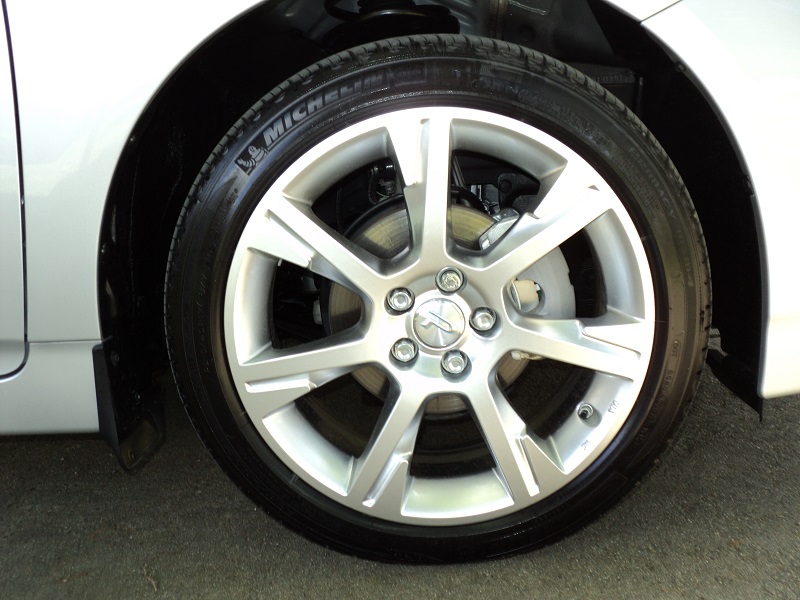

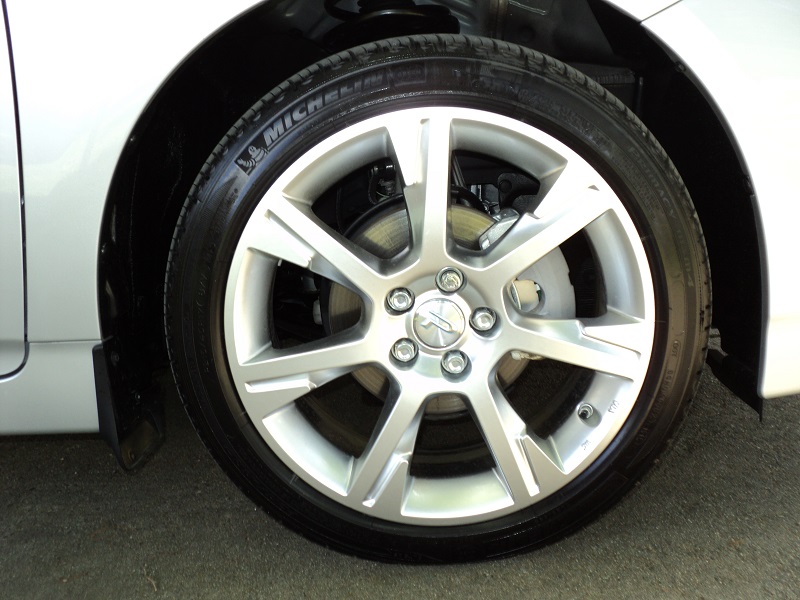

    You might want to check out the Michelin Primacy MXM4 Excellent LRR tire, comes in 17" size. Have them on the new 2013 I just got. P215/45R17. You might find that will be an alternative for you. They are a little noisier than the Energy Saver A/S but so far they seem to be doing very well in the MPG dept. Since I am still breaking in the new Prius, I can't attest to final MPG, but with the average so far everything looks pretty good to me imo. Haven't had them on wet pavement yet, but the ratings are supposed to be good traction also.
    Hope this helps you.

    Yeah, you never really know what is going to happen next until it does. But the Michelin Energy Saver A/S is a GREAT tire. I miss the one's I put on our Gen II last year.
    The Primacy's that I have on our Gen III are doing great, but they are a LOT noisier than the Energy Saver is.
    I am going to look into seeing whether I can get the right size (17") in the Energy Saver A/S. If so, when I wear out the Primacy's that are brand new, I will get the Energy Saver instead.

    Good info on the Primacy vs Energy Saver A/S. What offset are those ACE wheels on your Prius? And where did you get them?
