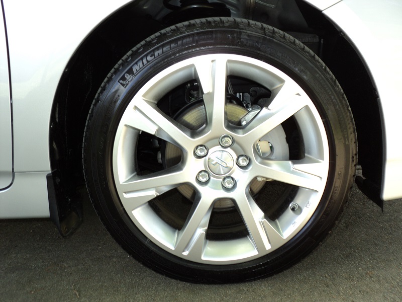

    Had the Michelin Energy Saver A/S 86T on our Gen II. They were great in all aspects. Definitely NOT a snow tire, so be aware of that if you live where the snow flies.
    I also agree the Primacy MXM4 are GREAT tires. I have a set of them (low profile 17") on our new 2013 Gen III Model Three Prius. The Primacy is a little noisier on the highway than the Energy Saver, but MPG and handling are excellent on both tires.
    Defenders are good tires, last a long time, but don't give as much MPG as the Energy Saver A/S or the Michelin Primacy MXM4 do.
    Check the ratings on Michelins website. That say's it all where LRR comes into play.
