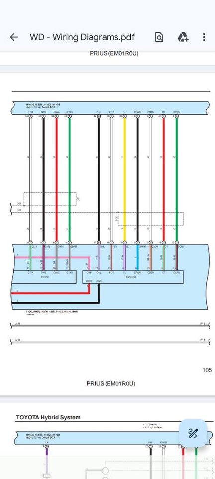

    Yes, that's right. The color coding on the visible part of the connector matches the hybrid wiring diagram.
    Problems can arise due to wire breakage or short circuits, then such error codes will appear.
    https://share.qclt.com/%E4%B8%B0%E7%94%B0%E6%99%AE%E7%91%9E%E6%96%AF%E5%8E%9F%E5%8E%82%E8%8B%B1%E6%96%87%E6%89%8B%E5%86%8Cpdf%E6%A0%BC%E5%BC%8F/repair%20manual/04pruisr/05/21bpm/0a4b253.pdf

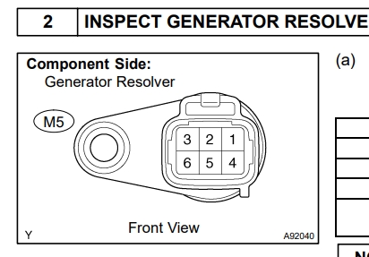

    Visual inspection and photos are good, but did you take measurements as indicated in manual in post #6?

    I can't locate the H17 HV control ECU connector in Prius. Any guidance, where is it? thank you

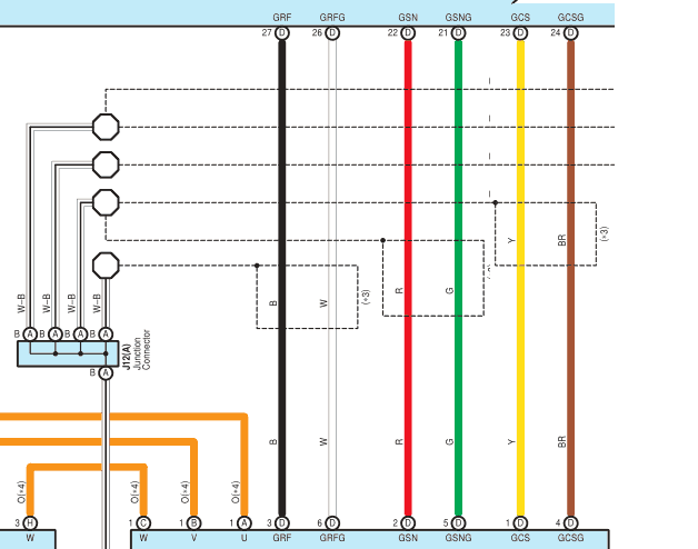

    You are looking at shielded cables. The shields are shown with dotted lines in the diagram here.
    The idea is to enclose some sensitive signal-carrying wire pair in a kind of Faraday cage (so the shield has to be grounded somehow) so that the signals on those wires don't interfere with signals on others nearby and vice versa.
    The actual shield can be made in a few different ways, like braiding very fine wires into a braid that goes all the way around the shielded wires, or just by wrapping some conductive metal foil around them. The shield still has to be grounded somehow; for a metal foil shield that usually means just running a bare wire all along it, so it's in good electrical contact with the shield all along, and then you just ground the bare wire at one end or the other or both.
    Here they have shown the black/white pair that carries the resolver field excitation signal to the sensor, the red/green pair carrying the sine signal back, and the yellow/brown pair carrying the cosine signal back, all in their own shields. For all those shields, the drain wires look connected to ground on one end, at splices where they turn into white/black-stripe wires and then ending up at the J12(A) junction connector.
    It's generally good enough to ground a shield at one end and not both, and in fact that saves you from ever having the shield turn into an unplanned current-carrying conductor if the ground potentials aren't exactly the same at the two ends. So yes, that drain wire probably just ends at the sensor ends without connecting to anything.

    The bare wire and foil tape are there for shielding. They connect to chassis ground and surround the insulated wires, reducing electromagnetic interference in the circuit signals.
    You'll want repair the wires and use foil to rewrap the harness as best you can before insulating the entire bundle. (maybe it'll be ok without that, maybe not).
    The shields are shown as dotted lines on the diagrams here. wire_shielding.jpeg

    Repairing shielded wire well is hard. Really hard. Is the damaged section maybe on a reasonably small piece of cable with a single plug at each end (no forks)? Because getting a good cable from the junk yard and replacing it is likely to turn out better than a repair on the damaged cable. On the other hand, if it is part of some massive loom which forks and runs all over the car replacing that could be nearly as difficult as repairing the shielded wire.
  17. ChapmanF
    28,705
    19,008
    It is, and would be much more work to replace than just repairing the damage. The other ends are at the HV control ECU under the passenger side of the dash.
    If it is foil shield with a drain wire, fold the foil back down over your repairs when you're done.
    If you tore some of the foil away, and you want to be fussy about it, wrap some kitchen foil over the repairs, make sure the bare drain wire touches it, and tape it up nice.
    The shielding already isn't continuous all the way to the ends; the signal wires are outside of any shield for several cm or so on each end, and terminate in unshielded connectors.
    The amount of worry I would dedicate to how the shield repair might be imperfect is: zero, unless I get it put back together and the ECU actually doesn't like the signals.

    This isn't "coaxial" cable - that has braided or woven conductors that are part of the signal path. This is just foil tape and an "earth drain" wire - not much to it.

    Continuing to work on this. Pic attached. On this resolver, the black wire (one of six wires) was barely hanging on, and when working on this it has broken away. There is a tiny stub of wire coming out of the resolver , if I make a good connection and hold it, the gas engine in the Prius started up. This is a good sign I think and when off the jack stands I will see if the car moves. The rror code was PO4AC. My question is, I see there are little gray "plug-like" leads into the resolver. Do these pull out so I could try a splice (temporarily) with a good connection to the resolver? Right now there is no way to keep the black wires held together. thank you.
