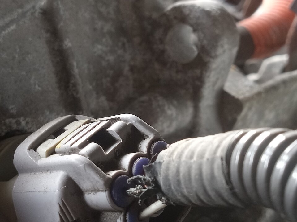

    Yes, itz the sensor on the wiring harness. This is the pic of the it. 20250523_154501.jpg

    Got it. That light gray thing is just a wiring connector. You can squeeze that tab and unplug it from the mating connector that is sticking out of the transaxle.
    Neither one is the sensor. The sensor is buried inside the transaxle where you aren't going to see it, and so are the wires from the sensor to that mating plug sticking out of the transaxle, so they are pretty well protected from damage.
    The only repair you need to make is of damaged wire to a connector plug.

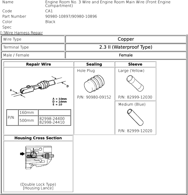

    It shouldn't be difficult. When you look in the electrical wiring diagram you see something like this (example only, this isn't the connector you're looking for!):
    So if you see that the repair wire part number is 82998-24400 (example only, not your part!), you go to a Toyota dealer and at the parts counter you give that number and they either go get the repair wire for you or they tell you it'll be in tomorrow morning.
    As you can see, the diagram you find also gives you other information you also need, like how the locking mechanism in the housing works so you can release the old terminals, and also the part numbers of the crimp sleeves you should use for splicing the repair wires to your harness.

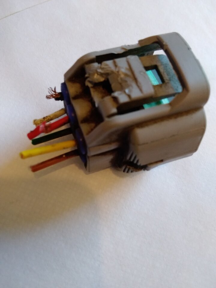

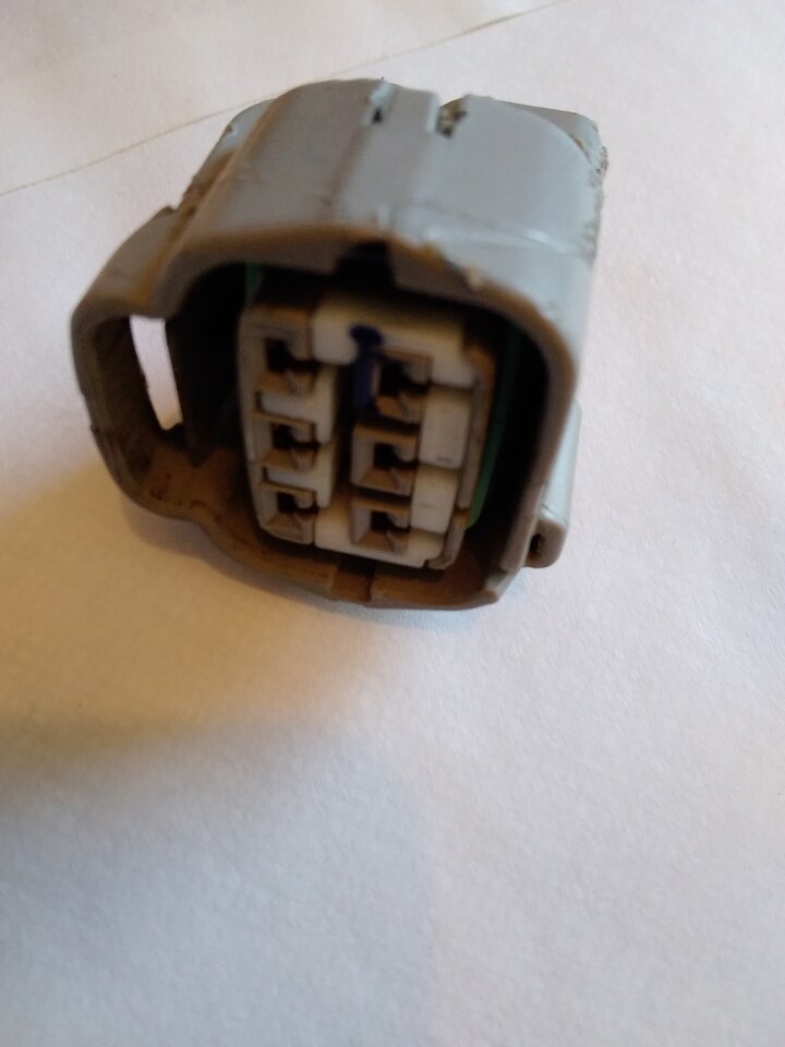

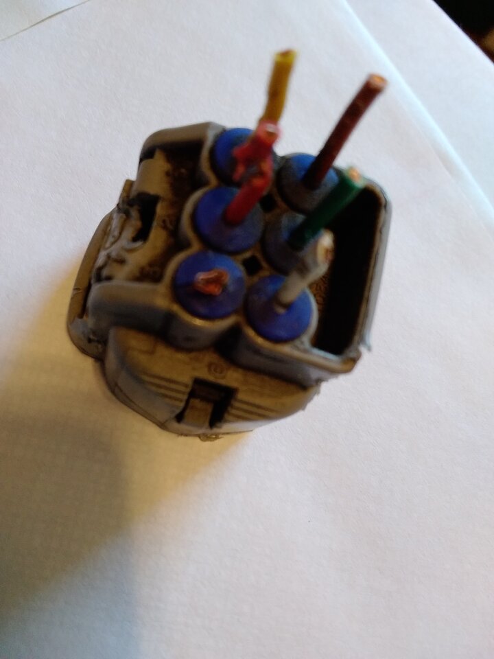

    20250630_191339.jpg 20250630_191313.jpg 20250630_191251.jpg Wanted to post an update on this with pics. I'm pretty sure this is 18 or 20 gauge wire, to answer a previous question. All error codes and lights have disappeared and I just drove the car down the road. A connector, 6 wire, was taken from another harness and each of the 6 wires was crimp-spliced and the replacement connector hooked up. See pics to see previous connector damage. It also looks like the connector had been removed before because the thing you push to disconnect looks damaged and some blue marker or ink can be seen that someone did long ago. An old service bulletin says put dielectric grease on this connector. Any suggestions for tape to wrap all the splices and wires together? Any questions welcome. One of the wires (black) had completey broken away from connector. All the help is Much appreciated.
